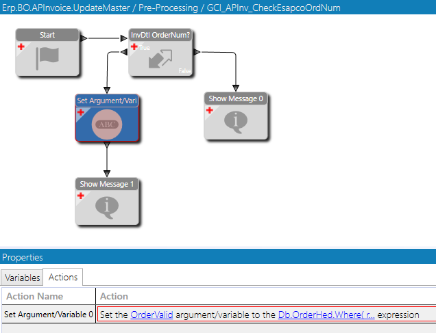

We have a UD Field in Order Entry that is also in APInvDtl. I’ve been asked to make a BPM to make sure the number entered in APInvDtl is actually a valid number in Order Entry.
I’m familiar with the one line code to look up a data base value in a BPM, but not sure how to make this search all values and return true/false.
Do I approach it the same way - Create a BPM Variable (OrderValid), search for the OrderNum_c in OrderHed, and then use a conditional widget to evaluate it as true or false? Or is there a slicker way?

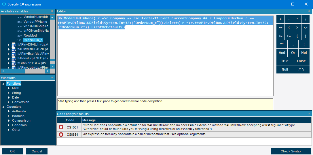

Db.OrderHed.Where( r =>r.Company == callContextClient.CurrentCompany && r.EsapcoOrderNum_c == OrderNum_c).Select( r =>r.OrderNum_c).FirstOrDefault()
(note - the above code didn’t like looking up the ttInvDtl table, so I changed it for the below screenshot, which still isn’t happy).

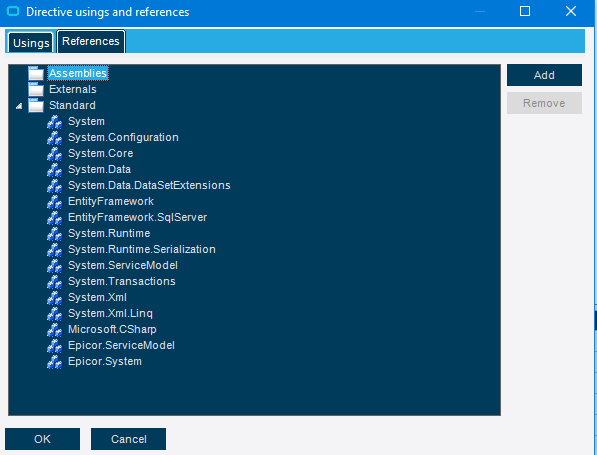

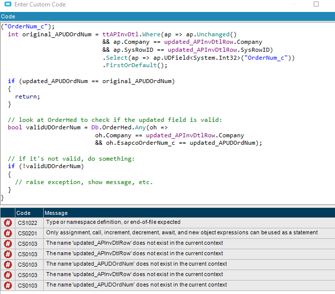

I pasted the code into a C# widget as a starting point, and get a handful of namespace, statement, and current context errors. Do I need to add a Using or Reference?
Hmm you shouldn’t need any usings or references since there’s nothing “external” going on here. Did the top of the code block get cut off when you pasted it?
Palm smacking forehead. Doh! Yup… Thanks so much!!!
