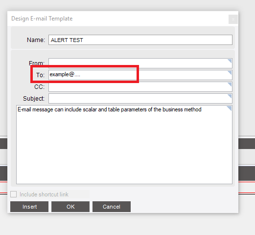

Is there any configuration that needs to happen before I can trigger an email alert with a BPM? In a simple test, I entered the “To:” field with my email address and was unsuccessful generating anything.
emailPrompt
You will need a from field, also your email server has to be setup in Epicor (Company Maintenance).
