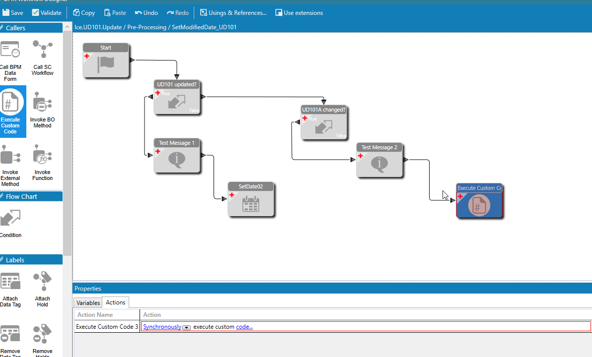

On a custom UD101 screen, I need to display the last modified date. So I’m trying to use a Pre-Proc method directive BPM on UD101.Update to set UD101.Date02 field, each time a change is made in either UD101 or UD101A. It works for UD101 but I’m stuck for the UD101A change. Using a Set field is not working ( I guess because this line has not changed.) How can I access UD101 when the change is made to UD101A ? I need to use custom code ?

Also tried to make a separate BPM, but same result. If I try to use the set field widget, this can’t work because it is not the ttUD101 line that’s been updated, right ?

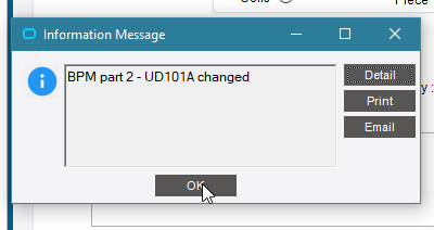

If I understand what you are saying… yes this is one reason what I was thinking a separate BPM for 101A - and maybe start with the simple stuff first - e.g. just criteria and a messagebox to confirm you are using the correct method - i.e. messagebox actually triggers when 101A is changed?
Once you are sure it is triggering as expected, then you can worry about figuring out how to update the related 101 record (not a tt table… the actual table)

Yes, the message box is triggered when 101A is changed. I thought there would be a way to update the field in ttUD101 table, since it seems to be accessible there.

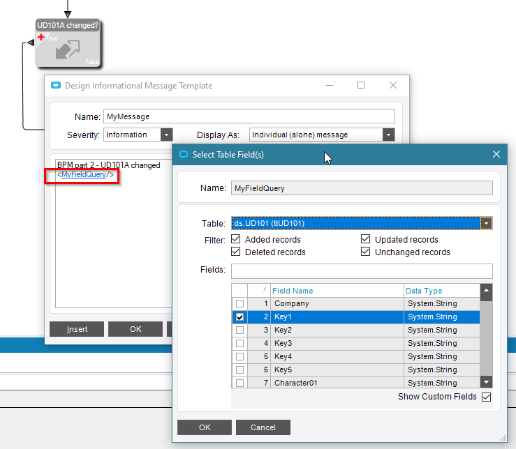

I tried but I doesn’t work. I also tried displaying a field from ttUD101 in my message, but nothing is displayed.

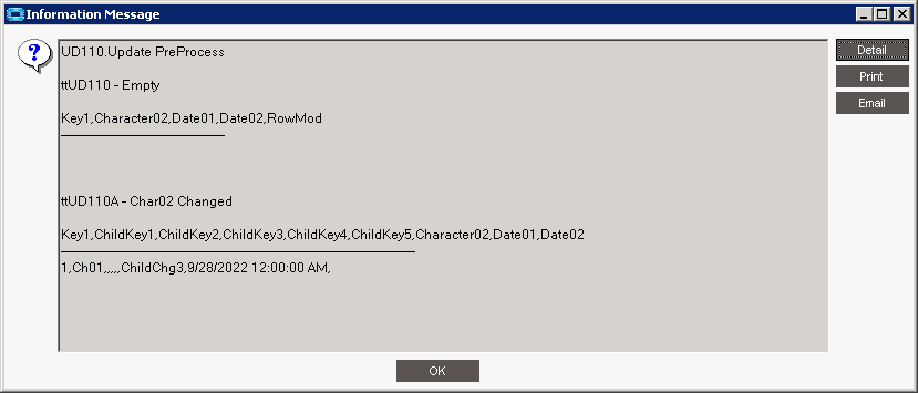

Yeah, I did a quick check ( using UD110 & UD110A )
  • notice in the screenshot of my test messagebox
  • changing UD110A and the table ttUD110A is populated record
  • BUT… the table ttUD110 is empty
This happens a lot in methods - where developers only use the bare minimum of ttTables.
Another reason I start with messageboxes besides to verifying criteria - can make sure what REALLY is/isn’t available.
