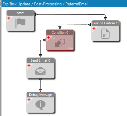

BPM to send email when task completes and quotehed UD field = true
I’m creating a BPM to send an email when QuoteHed.Quoted=TRUE and QuoteHed.PowerPoint_c=TRUE. This is working with Quote.Update, but not when completing the final task and marking it won sets Quoted=TRUE.
I did a trace, saw that Task.Update is being called, so I cloned what I did for Quote.Update, but the QuoteHed fields aren’t part of the Task data set.

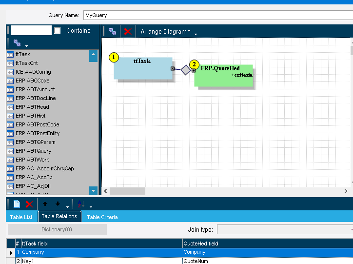

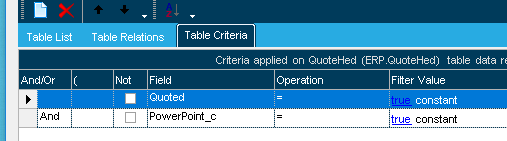

Hi Tanner - I got stuck modifying your code to add the variables from the QuoteHed and Customer tables, so I thought I’d try to get at the QuoteHed criteria via “Number of Rows in My Query”.
Seems Epicor doesn’t like joining the QuoteHed table to Task via Key1, which is a string in Task, but Int in QuoteHed. I get this error, but not sure how to to fix it:
There is at least one compilation error.
Update.Post.ReferralEmail.cs(120,143): error CS1061: ‘int’ does not contain a definition for ‘ToLowerInvariant’ and no accessible extension method ‘ToLowerInvariant’ accepting a first argument of type ‘int’ could be found (are you missing a using directive or an assembly reference?)

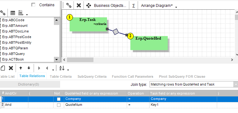

I just ran a test and I don’t see an issue in our environment (10.2.300.37) when creating just a BAQ with no tt table. FWIW I typically steer away from joining in memory tables to Epicor tables as it can cause performance issues (could be a bug as well). Try using the db tables for the join in the query. To get only the information for the related ttTask table, add it to the grid and then add filter criteria on the Erp.Task to select the correct record.
Hope this help,
Tanner
Table relations:
Criteria to filter table:
