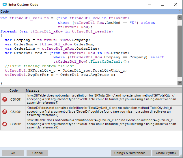

I worked with one of my programmers and we developed some code but we are still running into an error. See screen shot below:
3 of the 4 UD fields say they do not contain a definition but I set them up all the same way in their respective tables. Should I re do them?

you declare a variable as ttInvcDtl_xRow… but then call ttInvcDtl

the two lines
ttInvDtl.SKTotalQty_c …
ttInvDtl.AvgPerPer_c …
where is ttInvcDtl declared? do you mean to have ttInvcDtl_xRow there??

I do not think I have it declared but it still doesn’t explain why I am getting the error on 3 of the 4 UD fields…

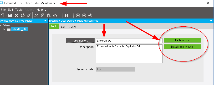

Look in the Extended UD Tab;e maintenance screen for those tables. First, it should show the data and table are sync’d
While you are there check the field names - just asking because PricePerPer sounds weird lol

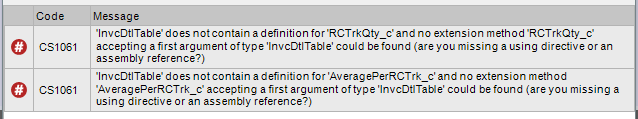

@Chris_Conn, we verified that everything is syncing properly. I recreated the 3 fields that were erroring out and did a regen and still getting the same error but only for the InvcDtl fields. Here is the code:
Erp.Tables.OrderDtl OrderDtl;
var ttInvcDtl_results = (from ttInvcDtl_Row in ttInvcDtl
where (ttInvcDtl_Row.RowMod == “U”) select ttInvcDtl_Row);
foreach (var ttInvcDtl_xRow in ttInvcDtl_results)
var Company = ttInvcDtl_xRow.Company;
var OrderNum = ttInvcDtl_xRow.OrderNum;
var OrderLine = ttInvcDtl_xRow.OrderLine;
var OrderDtl_row = (from ttOrderDtl_Row in Db.OrderDtl
where (ttOrderDtl_Row.Company == Company) select ttOrderDtl_Row).FirstOrDefault();
//Issue finding custom fields?
ttInvcDtl.RCTrkQty_c = OrderDtl_row.RCTrkTtlQty_c;
ttInvcDtl.AveragePerRCTrk_c = OrderDtl_row.AvgPrice_c;
Errors:
I keep going back to declaring ttInvcDtl. I am new to C# and getting help from our programmer so I need some more guidance.
Charles

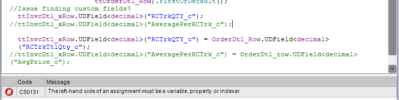

You can’t reference extended UD fields on the ttTables that way.
@josecgomez, then how would you go about doing it?
See @knash example above. It is like this:
theRowHere.UDField<TheTypeHere>("FieldNameHere");
//using my code above as a reference
i.UDField<decimal>("SKTotalQty_c") = myOrder.UDField<decimal>("TotalQtyUnit_c");
I think I got it… this would before the statement:
Right?
Here is where I am now:
The syntax through ttInvcDtl_xRow.UDField(“RCTrkQTY_c”);
is ok, but it errors on the next line.
