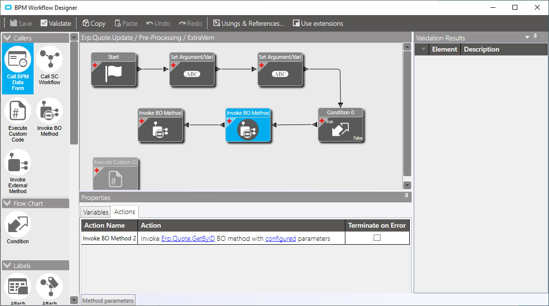

I use a pre-processing directive on the UD12.Update method.

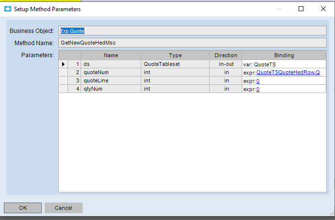

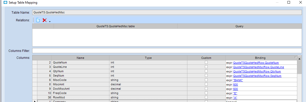

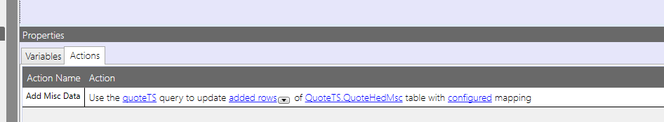

Once you have created the new record you need to assign it values (as you have done). However, I note that you have not the RowMod to ‘A’
Code is one way, but using the ‘Invoke BO method’ widget can make things easier to work with and easier to maintain.
You need to add the data to the new record you have created
I use the ‘Update Table By Query’ widget to do this
The mapping is my last post
Thanks to @surendrapal I was able to solve it.
