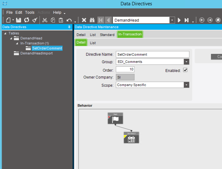

I ended up getting it to work via a In-Transaction Data Directive on DemandHead table with the
Set field syntax as I posted above. I’m having our users do more testing in our Pilot/Test environment before we go live with it but so far it’s working.
