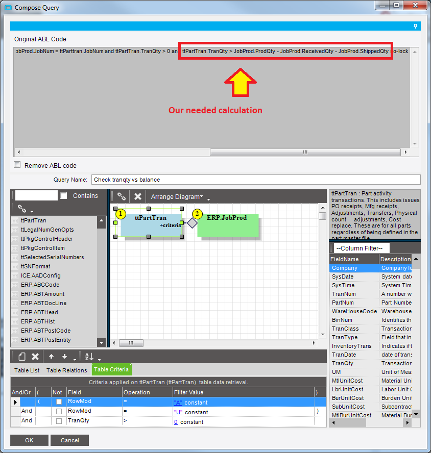

My team and I are working through our E9-10.2 conversion. We’re nearly finished with our BPM Method Directives. However, we’ve run into an “immovable object” of sorts. We need to have calculations of a table’s fields done on the fly in this query builder. As an example, we’ll need to find the difference between two decimal fields in JobProd and compare them to a ttPartTran field.
Easy, right?
Wrong–at least for us so far. We’ve figured out that we can utilize BPM Workflow Designer’s “Variable” objects in a “Set Argument/Variable” object, where we can utilize the Method Directive’s associated tables and fields to fill the Variable with a calculated value. We can then reference this Variable in the Query Builder.
However, we cannot access an unrelated table’s fields in these “Set Argument/Variable” objects.
Does anyone have a thought for how to do this?

I’m going to set a variable that I’ll call “TestDecimal” with the following code (modified from yours!):
(decimal?)(from row in Db.JobProd where row.Company == ttPartTranRow.Company && row.JobNum == ttPartTranRow.JobNum select row.ProdQty).FirstOrDefault() ?? 0
(This substitutes the part of the ABL code: JobProd.ProdQty)
So long as the conditions (row.Company == ttPartTranRow.Company, row.JobNum == ttPartTranRow.JobNum) are reflected in the “Compose Query” builder as well, can I expect the comparison to the “TestDecimal” variable to work as designed in the query builder?

Yes, that’s what we do. Obviously a single variable only works for something that’s common to all rows if there are multiple rows you’re looking at.
