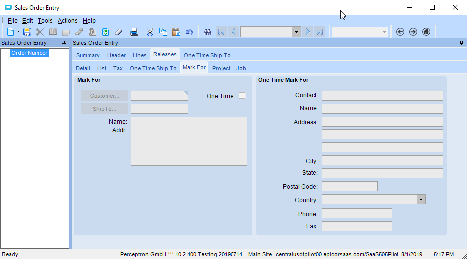

Have you looked at the Mark For capability? I’m not sure if Manifest looks at it though.
Help says it’s for the End Customer when shipping to distributors, etc.
