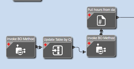

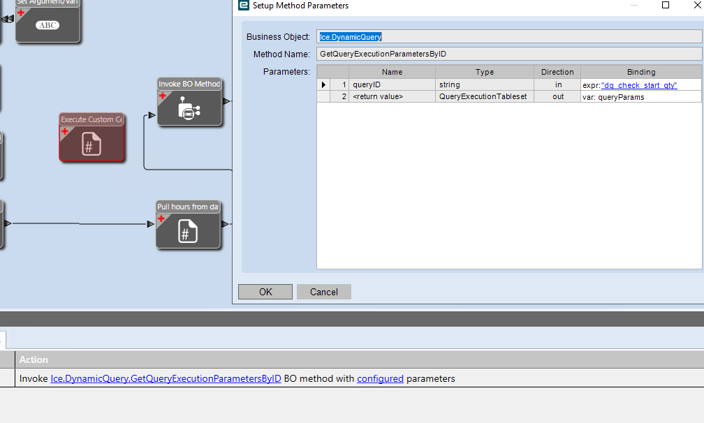

Hello, I’m trying to find a way to pass multiple parameters to a BAQ and get the results back. I’ve only had to do one in the past, which I accomplished with widgets.

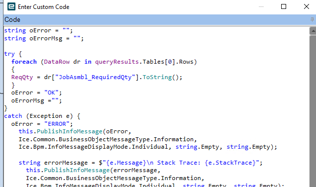

By getting the executionParameters, Updating the ID/Value of the parameter, giving the BAQ the executionParametersDataset, and then pulling the returned value using code. (See below)
Now I need to use a BAQ that has three different Parameters. I couldn’t figure out a way to do it using the same method, so I’ve tried doing this:

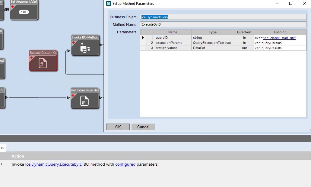

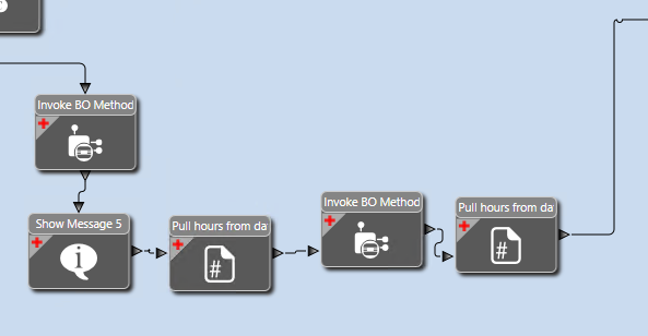

I get the executionparametersdataset in the same way as before, then execute that code, then invoke the BAQ as before, and try to pull hours. It seems to take the parameters, but it returns 0 for all values… but if i type the values in manually I get the actual results(In the BAQ itself)

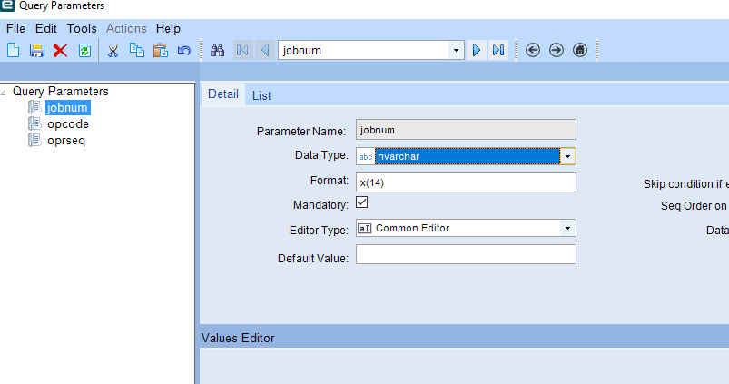

all 3 are nvarchars, and all 3 are strings inside of the BPM…
Any ideas?

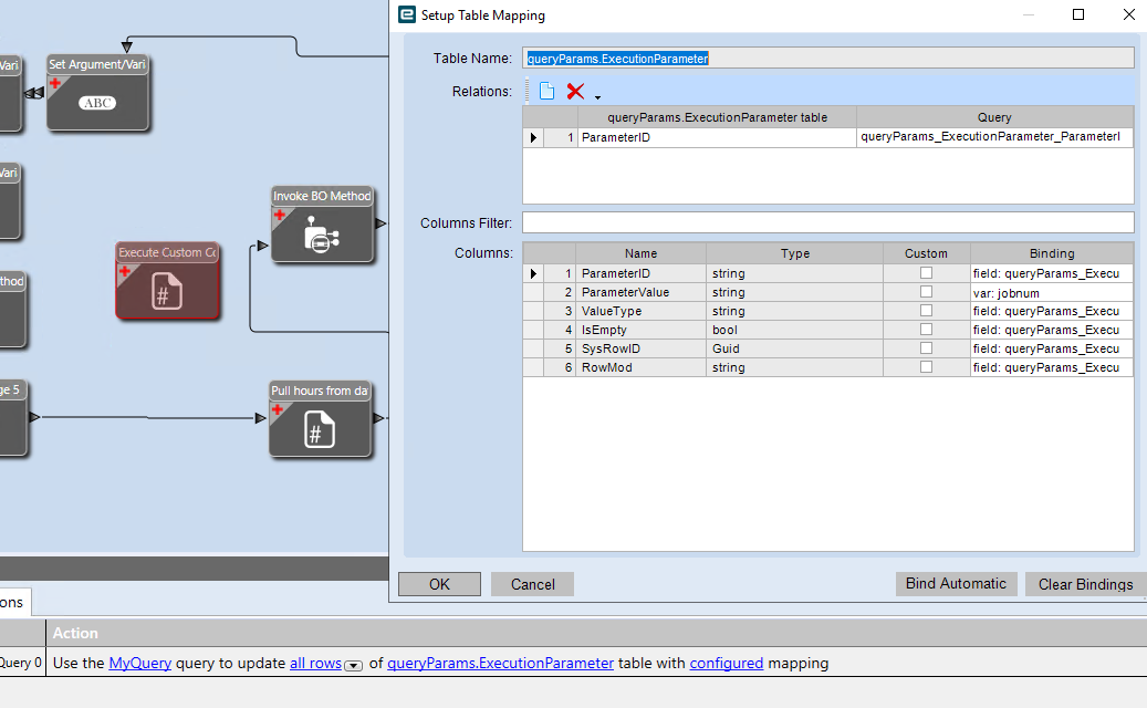

I ended up figuring it out using just the widgets, when I was setting the query, I changed the parameterID to the two other ones, and set the values seperately, so its basically just three update row widgets to get the correct parameters.
