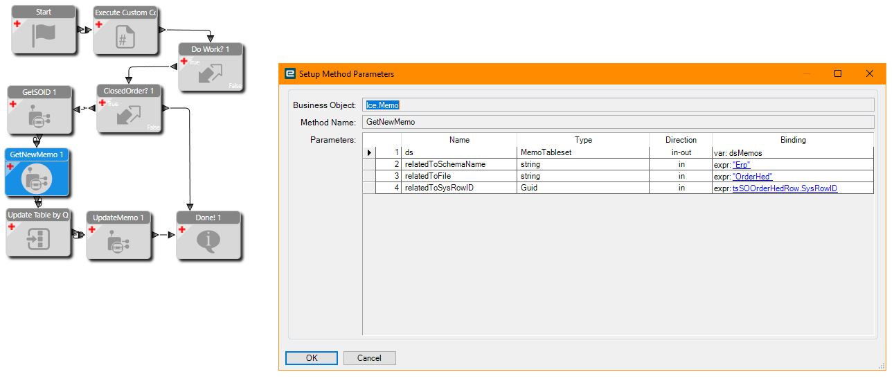

I have done this with a BPM and a UBAQ. You need to use the Ice.Memo BO, and the GetNewMemo method. I setup the BPM like this:
