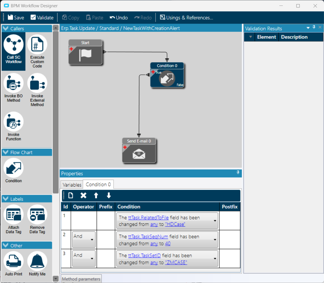

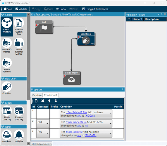

DATA DIRECTIVES: Neither the Standard nor In-Transaction conditions are triggered, even though the Conditions–based on what I can see in a BAQ I run prior to and after clicking “Save”–are true. See screenshot. (NOTE: In-Transaction BPM Workflow Designer doesn’t include a widget for email generation.)

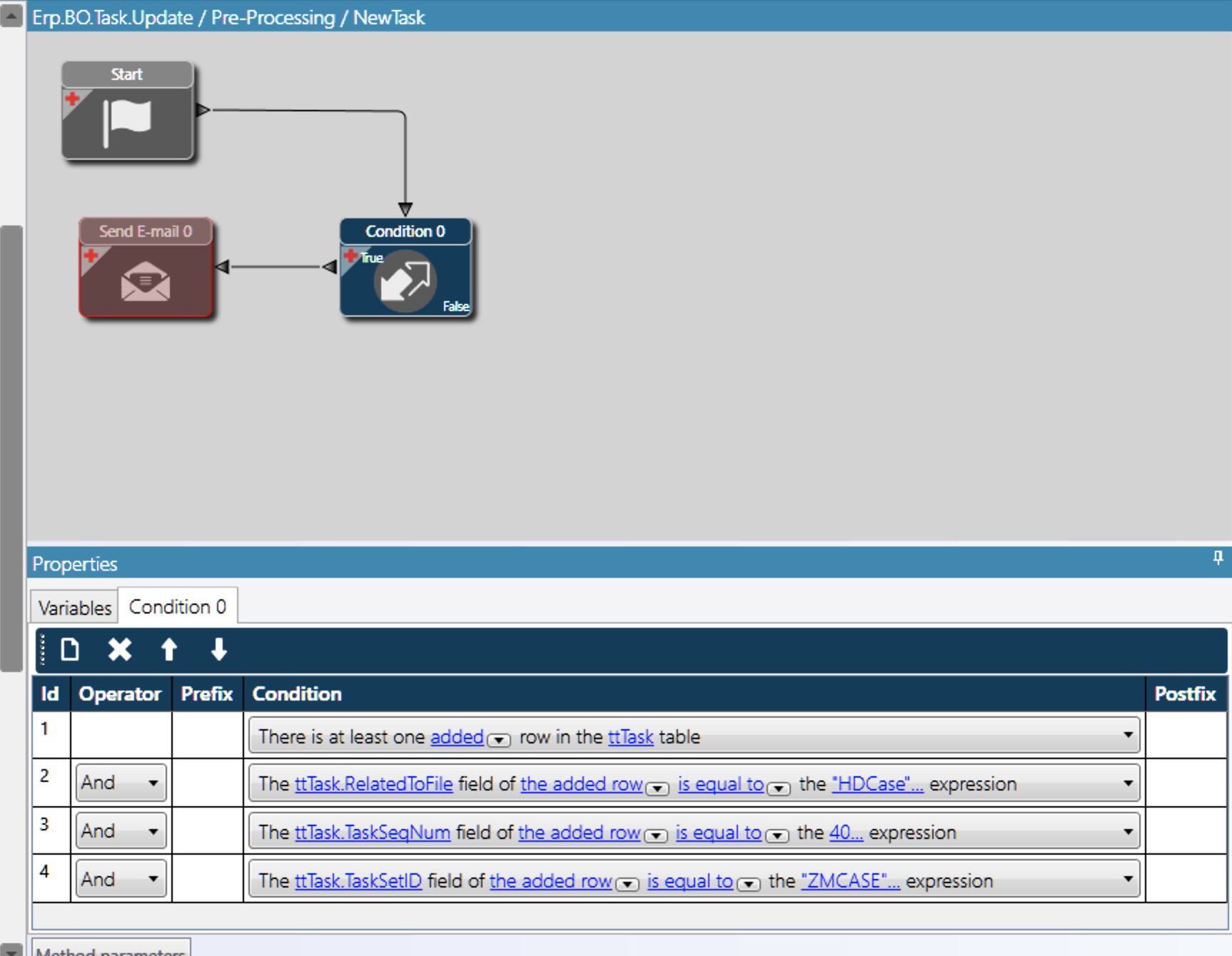

METHOD DIRECTIVES: When clicking “Save,” E10 triggers the Method Erp.Task.Update. A Pre-Processing BPM fails because the data row doesn’t exist yet. A PostProcessing BPM fails on the data condition because all the data has been saved, so as far as the BPM is concerned the row is no longer new. It might be possible to replace Epicor’s existing functionality with a Base Processing BPM, but that feels error prone since I don’t know with certainty everything Epicor does when its own code is called.
What you might want to do is pass data from the pre to the post, possibly via the call context.
You can also enable a post processing directive from a pre processing directive.

I am truly thankful to all three respondents. I finally got the results I want, and with this want to share what I found along the way. I couldn’t get @MLamkin’s suggestion to work but I might have been doing something wrong; she recommended the condition “There is at least one ADDED row in the ttTASK table”; this feels like it should work but I’m thinking the row is added as a part of the base processing rather than either pre-processing or post-processing and hence fails. My hope was to use either Pre-Processing or Post-Processing; I successfully avoided the Base Processing tab.

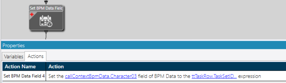

@klincecum offered the first suggestion that was helpful to me, “Pass data from the pre to the post, possibly via the call context.” I did this with the setter “Set BPM Data Field”, copying the data I needed into callContextBpmData. from ttTaskRow. as seen in the screenshot:
