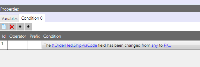

Brian - That didn’t work, unfortunately.
Brian - I added the 2nd OR line, and it’s still not catching it the blank to PKU case… It does catch changing any non-blank ShipVia to PKU though. So close… Thanks for the suggestion.
Strange, I have tested it and it works in all cases that the ShipVia is changed, whether new, from another or from blank.
Brian - I’ll try it in our clean EpicorEdu environment where we don’t have any other BPM’s. Maybe we have something stepping on it. I’ll try adding message pop ups to troubleshoot. Thanks for helping.
That is what I used, a message popup and the bpm was triggered each time.
