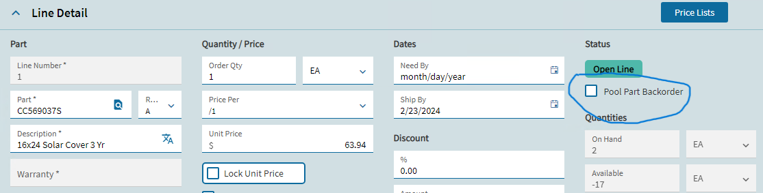

I am new to BPM’s in Epicor and I am not a strong C# developer. I am looking for some assistance, preferably using the widgets to get this done. I have to create a BPM that needs to check each line in Sales Order Entry that corresponds to the received line in Receipt Entry that contains the same part number. Now the only way the part number matters is if in Sales Order Entry it is marked with a back order checkbox. As shown in the screenshot.
Once the corresponding items are found, an email needs to be generated to a specific email address with an email that states, “Part #_________ has been received and is a backorder part” I need to combine parts that are on the same Pack ID into one email.

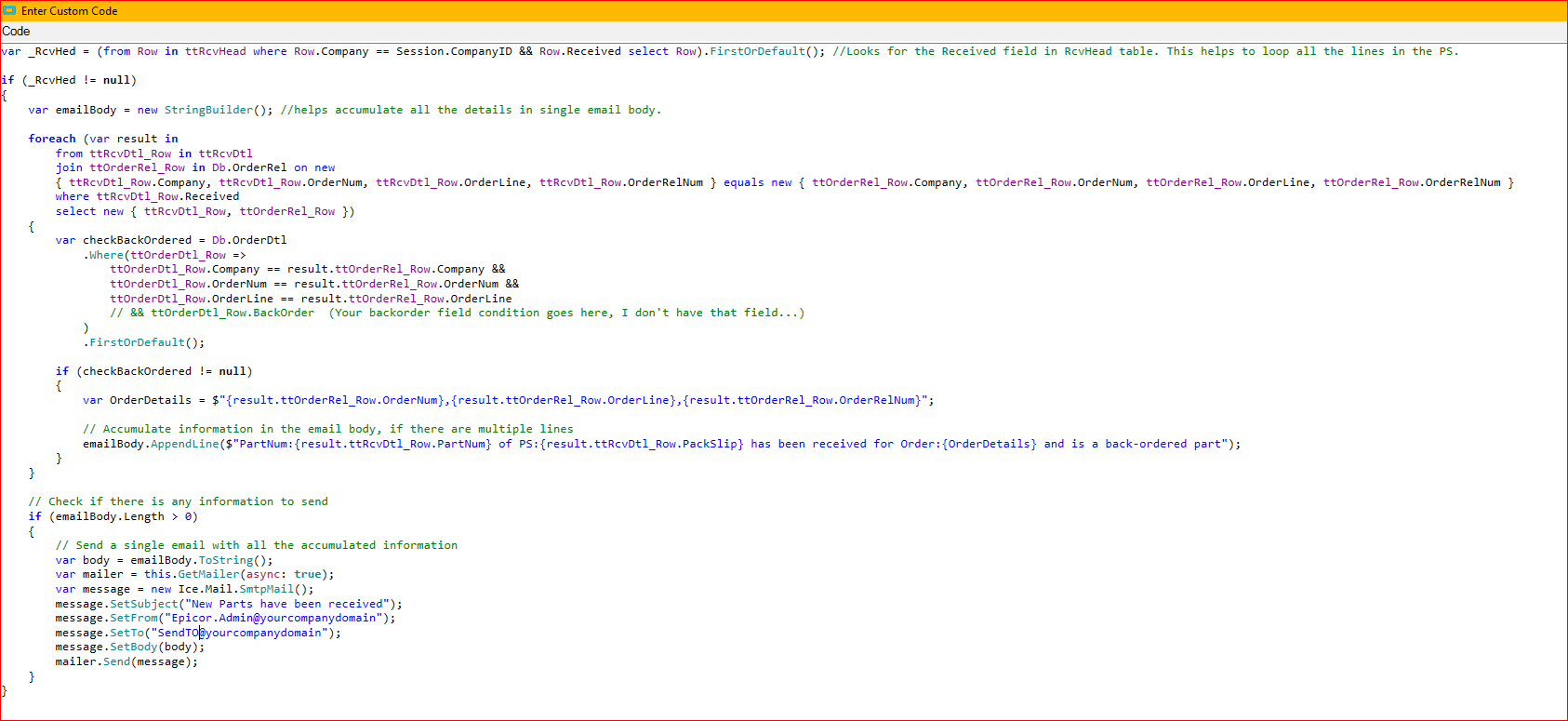

Do you want to try through c#?. It is almost 50 lines of code but will get you through with a simple Post-Processing at Receipt.Update using a custom code widget. This code will send email as well.
Here is the snapshot:
and here is the code:
var _RcvHed = (from Row in ttRcvHead where Row.Company == Session.CompanyID && Row.Received select Row).FirstOrDefault(); //Looks for the Received field in RcvHead table. This helps to loop all the lines in the PS.
if (_RcvHed != null)
var emailBody = new StringBuilder(); //helps accumulate all the details in single email body.
foreach (var result in
from ttRcvDtl_Row in ttRcvDtl
join ttOrderRel_Row in Db.OrderRel on new
{ ttRcvDtl_Row.Company, ttRcvDtl_Row.OrderNum, ttRcvDtl_Row.OrderLine, ttRcvDtl_Row.OrderRelNum } equals new { ttOrderRel_Row.Company, ttOrderRel_Row.OrderNum, ttOrderRel_Row.OrderLine, ttOrderRel_Row.OrderRelNum }
where ttRcvDtl_Row.Received
select new { ttRcvDtl_Row, ttOrderRel_Row })
var checkBackOrdered = Db.OrderDtl
.Where(ttOrderDtl_Row =>
ttOrderDtl_Row.Company == result.ttOrderRel_Row.Company &&
ttOrderDtl_Row.OrderNum == result.ttOrderRel_Row.OrderNum &&
ttOrderDtl_Row.OrderLine == result.ttOrderRel_Row.OrderLine
// && ttOrderDtl_Row.BackOrder (Your backorder field condition goes here, I don’t have that field…)
.FirstOrDefault();
if (checkBackOrdered != null)
var OrderDetails = $“{result.ttOrderRel_Row.OrderNum},{result.ttOrderRel_Row.OrderLine},{result.ttOrderRel_Row.OrderRelNum}”;
// Accumulate information in the email body, if there are multiple lines
emailBody.AppendLine($“PartNum:{result.ttRcvDtl_Row.PartNum} of PS:{result.ttRcvDtl_Row.PackSlip} has been received for Order:{OrderDetails} and is a back-ordered part”);
// Check if there is any information to send
if (emailBody.Length > 0)
// Send a single email with all the accumulated information
var body = emailBody.ToString();
var mailer = this.GetMailer(async: true);
var message = new Ice.Mail.SmtpMail();
message.SetSubject(“New Parts have been received”);
message.SetFrom(“Epicor.Admin@yourcompanydomain”);
message.SetTo(“SendTO@yourcompanydomain”);
message.SetBody(body);
mailer.Send(message);
You can even set CC and BCC if needed.
