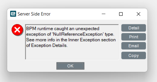

I keep getting this error:
All I have in the BPM is an invoke BO to InvTransfer.ChangeFromBin and I’m using dsPartWhseRow.PrimBin for the ipBinNum parameter.
What is triggering the BPM is Part.Update. Doing this at the pre-processing level. The condition is set to when the Primary bin changes from any to another. Tested it with sending an email, which worked.
It’s like it’s not getting the value from dsPartWhseRow.PrimBin value. Yet I can get it when I do a popup window or email.
I know there is other BO methods that need to be called to actually move the inventory, I wanted to do each step to confirm it worked before adding the next step.
my first thought is that hasn’t been updated yet, because it’s a pre-proc BPM.
Changed it to Post and tried a couple different ways but no go.

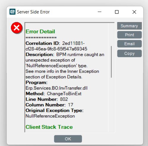

Looks like the issue all comes down to InvTransfer.ChangeToBin
Getting this error:
Not really enough context to help code snippet. It looks like the ChangeToBin method you are calling is not being provided the correct context i.e missing some setup. Trace in Dev Tools the calls that are made by the app to model. It seems a little odd to me that you just want to move the stock without adding a material movement for someone to action it or a label for someone to move it physically though.

When I just try to invoke only the changetobin or changefrombin (tried both cause why not), I get the nullreference. Even though that same variable is showing in a popup if I disable the BO method invoke. So it’s not null.
The only variable that changetobin or changefrombin needs is the bin (ipToBinNum.)
Based on what testing I’ve done, that method is the problem, if I could just get that to work, the rest would I imagine.
