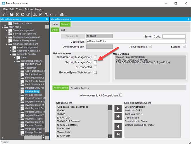

there are specific menu items that need to be set as accessible only for security manager the last 3 days of the month, so no one but manager can use them and the first day accessible for everyone again.

thank you for your reply, normally invoice entry is available for specific security group the entire month, but i want it to set the menu item accessible only for security manager 3 days before the end of the month.

hi all, thank you for all your responses and ideas. The company i work for runs an “end of month” process and they need to prevent employees to log invoices during the last 3 days of the month. Only Accounts payable manager should be able to do it during those 3 days.
