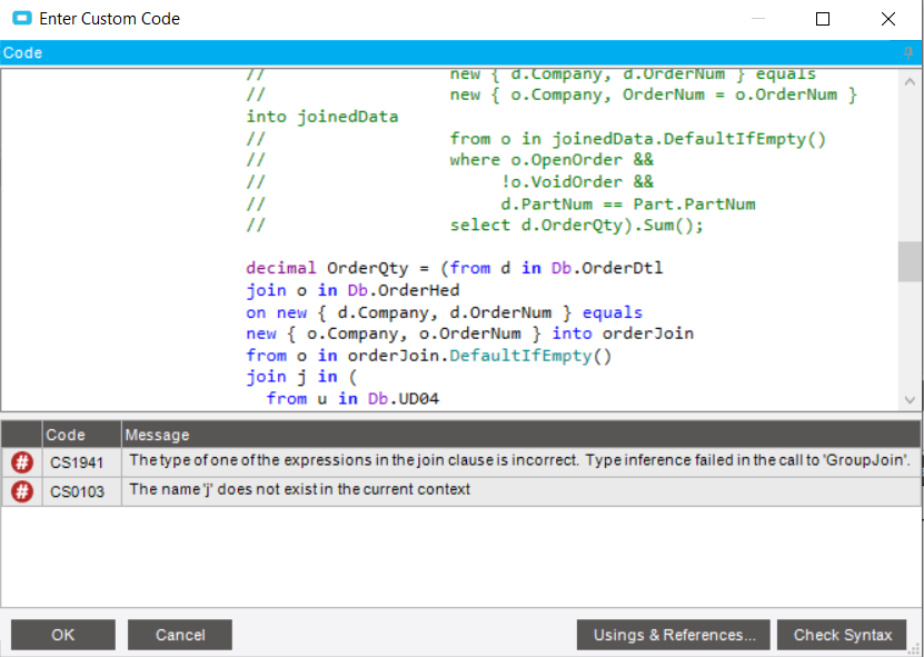

I try the code is not working. After modify abit and new error raised.
By the way, can know how u throw the question to chatGPT? As i cant get the same output as yours.

                        decimal OrderQty = (from d in Db.OrderDtl
                        join o in Db.OrderHed
                        on new { d.Company, d.OrderNum } equals
                        new { o.Company, o.OrderNum } into orderJoin
                        from o in orderJoin.DefaultIfEmpty()
                        join j in (
                          from u in Db.UD04
                          join h in Db.JobHead
                          on new { u.Company, u.Key1 } equals
                          new { h.Company, Key1 = h.JobNum } into jobJoin
                          from h in jobJoin.DefaultIfEmpty()
                          where !h.Cancel_c
                          group new { u, h } by new { u.Number01, u.Number02, h.PartNum } into gj
                          select new
                            Number01 = gj.Key.Number01,
                            Number02 = gj.Key.Number02,
                            PartNum = gj.Key.PartNum,
                            ProdQty = gj.Sum(x => x.u.Number04)
                        on new { d.OrderNum, d.OrderLine, d.PartNum } equals
                        new { OrderNum = j.Number01, OrderLine = j.Number02, PartNum = j.PartNum } into prodJoin
                        from j in prodJoin.DefaultIfEmpty()
                        where o.OpenOrder &&
                              !o.VoidOrder &&
                              d.PartNum == Part.PartNum &&
                              (d.OrderQty - (j.ProdQty ?? 0)) > 0
                        group d by 1 into gj
                        select new
                          ToBuildQty = gj.Sum(x => x.OrderQty - (j.ProdQty ?? 0))
                        }).FirstOrDefault();
