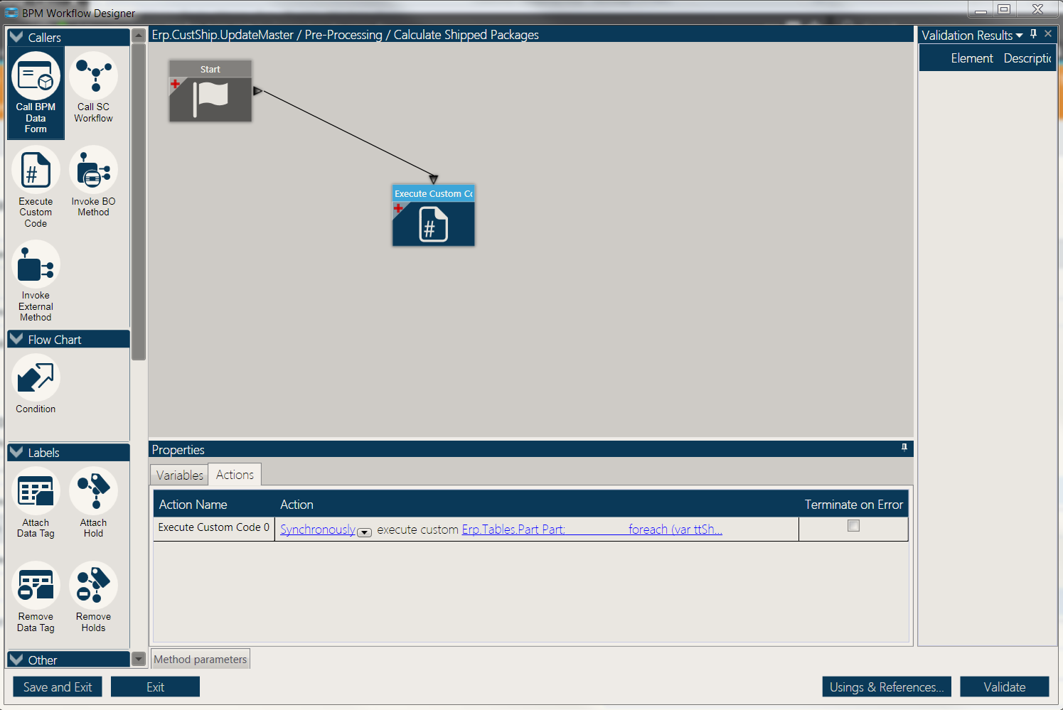

We had a custom BPM made when we first integrated Epicor, and I believe it is causing issues when processing customer shipment entries. It is only happening when saving inter-company shipment entries, and it isn’t consistent. We haven’t been able to narrow it down to one part, or a certain threshold of quantity, or anything really. Epicor will hang for up to 3 hours when saving. The lines seem to be entered within 1 hour of clicking save but the program still hangs. Sometimes, it will process within a few minutes with no issues. A suggestion from Epicor is shown below. I made these changes but there was no difference in performance.

ShippingBPMIssue2

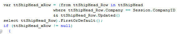

i also suggest to move this BPM to the ship method instead of MasterUpdate, and start with tt in ShipHead, in addition to track log and compare, you can publish an info message after each code block to check whether your IF condition statement is actually working as you want.
PublishInfoMessage(“Message1”+“Message2”,Ice.Common.BusinessObjectMessageType.Error,Ice.Bpm.InfoMessageDisplayMode.Individual,“BusnissObjectName”,“MethodName”);
