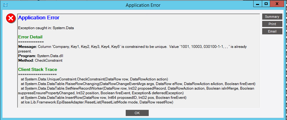

I tried to put the BPM on UD100 Update post-processing. The BPM needs to call UD100 UpdateExt to fill the child table and I get an error that I am trying to add a duplicate record to UD100. This error happens after the child table gets filled, but those records get rolled back at the error.

Error message for reference. The values relate to a UD100 record, not a UD100A.

Last edit: on the error, maybe you just need to change your RowMod to U instead of A?

For the rowmod - I had it set to U already but I can try A I guess.
So you do understand that UpdateExt calls Update and it call Update in such a way that the BPMs on Update will run? Unless you are conditionally calling UpdateExt so that it would only get called once, if you did not hit the error you would have an infinite loop (I believe Epicor would catch it after 1000 iterations and then fail).
Why are you not able to do the Child Table update from the Post Processing of Update instead of calling UpdateExt and having it do the Child Table update?
can you actually see what duplicate row in your test data? and i agree with you doing it with a BPM should be your 1st solution, however you need to trigger your BPM when the event of ‘click’ this button occurs on the UI , then on the UI customization, simply add a code to set any chosen BPMCallContext parameter to true, then put the row mod to update (U) then run the update, this will trigger your BPM becouse it is set as condition “true” at Update method directly, the code i use for that is:
