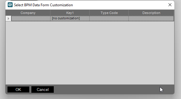

Hi,
Any ideas why customization are not visible?
