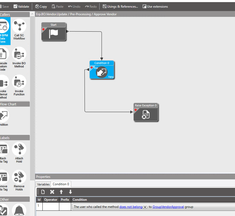

I’m trying to create a BPM to control on approved checkbox, only allowing user from a certain security group to check it.
I’ve created a method directive on Vendor.Update BO but I’m facing the issue below:
Issue: The BPM wouldn’t allow un-approved supplier creation, exception from the BPM will appear
Expectation: BPM would allow normal user to create supplier and save it if the approved button is not checked.
Appreciate if anyone can provide some ideas for this requirement.
