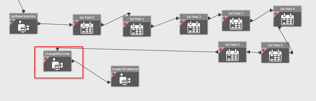

To have the business logic calculate the charges based on the percentages do things in this order.
1 - Call GetNewOrderMsc
2 - Set Fields
3 - Call ChangeMiscCode

Thank you very much for the reply on this. I tried modifying the BPM based on your suggestion and it worked as needed for auto calculating the amounts and percent for the msic. charge. Would you also be able to assist me with how to remove the misc. charge from the OrderDtl line if the part is changed to a non-surcharge needed item? In the BPM that I originally uploaded the verification was done but I was simply displaying an informational message, instead of the message I would just want to remove the associated surcharge from the line.

Sorry for the delay. I did get this working. I had to create a UD field on the OrderDtl to be marked as True if charges need to be added. I did this with a Post-Processing directive on SalesOrder.ChangePartNumMaster when OrderDtl.RowMod = A. I then created a Pre-Processing directive on SalesOrder.Update where I assigned various information (OrderNum, CustNum, ProdCode) to different callContextBPMData fields to use in a Post-Processing directive since I could not find this needed data in the dataset of the Post-Processing directive. This also gets called when OrderDtl.RowMod = A. The Post-Processing directive then gets enabled and uses the values stored in the callContextBPMData fields to assign certain charges based on their values, and I also had to use them for parameters in the SalesOrder.GetNewOrderMsc and SalesOrder.Update methods I had to invoke in the process.
Basically, this series of BPM’s gets called every time a Line is added and checks for the Product Group and the Plant creating the line so the correct Misc. Charge gets added.
