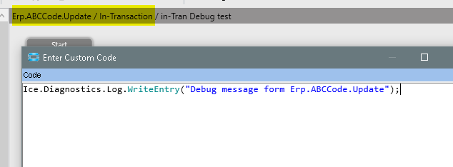

The most common method for debugging in Custom code in a BPM is to write to the event log.
edit
like:
Ice.Diagnostics.Log.WriteEntry(msg)
more details in topic:
Does anyone know where is the server event log is?
There are many things that say logs, so it’s confusing what is what.
Where does Ice.Diagnostics.Log.WriteEntry(msg) this write to?
It writes to the server hosting the E10 App pool.
that was generated from a DD BPM with a custom code widget :slight_smile:
