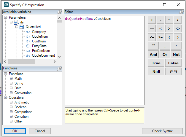

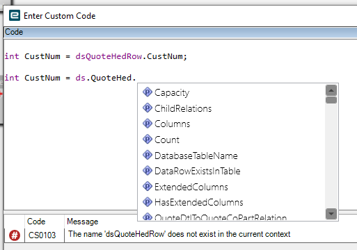

Followup question - Is there an easy way to access the tables within custom code? The variables available in the Expression dialog are not available in the Custom Code area. Eg:
When you use the “Specify C# expression” widget in the BPM designer, the code in the background is actually doing this:
var dsQuoteHedRow = Epicor.Customization.Bpm.EnumerableExtensions.GetSingleRow(ds.QuoteHed, "ds.QuoteHed");
this.CustNum = dsQuoteHedRow.CustNum;
So in your custom code you would need to do something like that or this:
var dsQuoteHedRow = ds.QuoteHed.FirstOrDefault();
if (dsQuoteHedRow != null)
Perfect tysm!!
