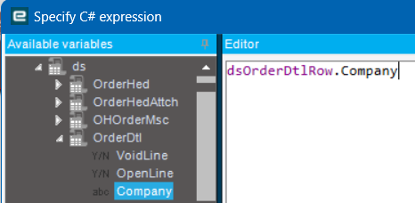

I am trying to access the field PartPlant.MinimumQty field in a Post Process BPM on Erp.BO.SalesOrder.ChangePartNumMaster.

CS0103 The name ‘dsOrderDtlRow’ does not exist in the current context. I have found the ‘dsOrderDtlRow’ when I looked at setting a variable

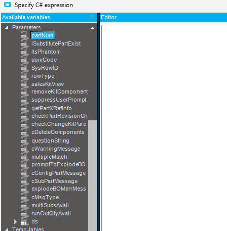

You can either right click in the Editor window or (depending on the exact widget) see all parameters and other objects in the tree menu on the left side of the window.
You query should look something like this:
int jgrTargetStock = Db.PartPlant.Where(x =>
            x.Company == callContextClient.CurrentCompany &&
            x.PartNum == partNum)
   .Select(y => y.MinimumQty)
   .FirstOrDefault() ?? "@@@";

The interface doesn’t work correctly as far as I know when referencing fields inside of datasets. “dsOrderDtlRow” is not really available in code, you have to build it. Something like:
OrderDtlRow dsOrderDtlRow = ds.OrderDtl.Where(r=>!r.Unchanged()).FirstOrDefault();
