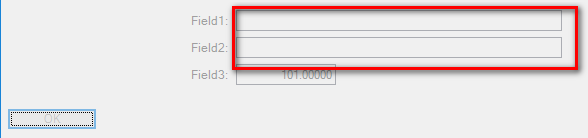

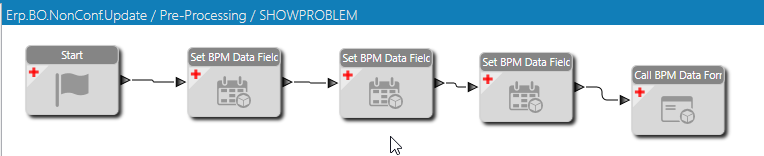

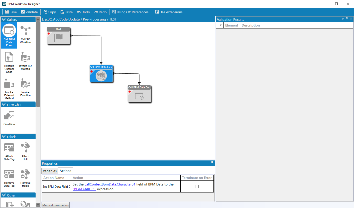

I was testing our customizations in Kinetic 2022.1.9 and discovered that BPM data forms are not correctly receiving character fields that have been set in the directive workflow (ie Set the BPM
Character01,Character02,etc). I know we need to eventually move away from them since they are not supported via Kinetic, but just curious if anyone found a simple way to address this?

looks like the variable loses scope and then blanks are sent back to the client.

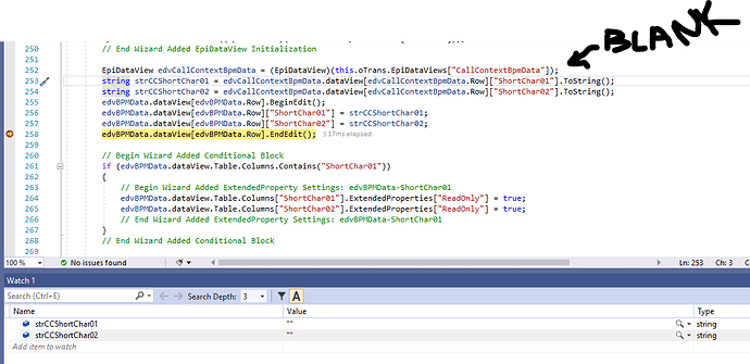

Ken–what’s your endgame with setting the context beforehand? Is it to pre-populate fields with something? As much as I dislike the suggestion–what about moving it to a BPM Form customization and pre-populate the fields in the UI code?
That is what I am looking into now. When is the callContextBPMData data getting cleared out.
If it means enhancing the customization, then that won’t be the end of the world. As the form already has a customizations (part/job/serialnumber adapters for lookups)

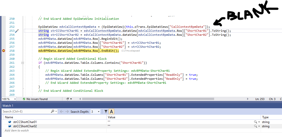

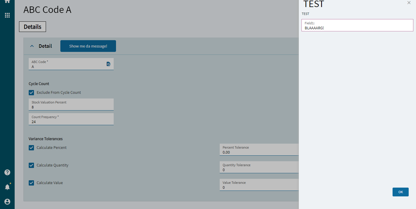

The CallContextBpmData data shows in the message box.
The CallContextBpmData is blank on form load of the BPM Data Form.
Is there another way to pass data into the BPM form?
// Begin Wizard Added EpiDataView Initialization
EpiDataView edvBPMData = ((EpiDataView)(this.oTrans.EpiDataViews["BPMData"]));
// End Wizard Added EpiDataView Initialization
EpiDataView edvCallContextBpmData = (EpiDataView)(this.oTrans.EpiDataViews["CallContextBpmData"]);
string strShortChar01 = edvCallContextBpmData.dataView[edvCallContextBpmData.Row]["ShortChar01"].ToString();
string strShortChar02 = edvCallContextBpmData.dataView[edvCallContextBpmData.Row]["ShortChar02"].ToString();
edvBPMData.dataView[edvBPMData.Row]["ShortChar01"] = strShortChar01;
edvBPMData.dataView[edvBPMData.Row]["ShortChar02"] = strShortChar02;
Add this:
edvBPMData.dataView[edvBPMData.Row].BeginEdit();
edvBPMData.dataView[edvBPMData.Row].EndEdit();
Right, but isn’t that why you’re trying to set it in the customization?
What’s in ShortChar01/02? Is that something that can be coded into the UI or is it specific from the calling form?
Might be easier to show the whole function.
We have BPMData and CallContextBpmData dataviews in play.
private void SetExtendedProperties()
string strCCShortChar01 = edvCallContextBpmData.dataView[edvCallContextBpmData.Row]["ShortChar01"].ToString();
string strCCShortChar02 = edvCallContextBpmData.dataView[edvCallContextBpmData.Row]["ShortChar02"].ToString();
edvBPMData.dataView[edvBPMData.Row]["ShortChar01"] = strCCShortChar01;
edvBPMData.dataView[edvBPMData.Row]["ShortChar02"] = strCCShortChar02;
// Begin Wizard Added Conditional Block
if (edvBPMData.dataView.Table.Columns.Contains("ShortChar01"))
// Begin Wizard Added ExtendedProperty Settings: edvBPMData-ShortChar01
edvBPMData.dataView.Table.Columns["ShortChar01"].ExtendedProperties["ReadOnly"] = true;
edvBPMData.dataView.Table.Columns["ShortChar02"].ExtendedProperties["ReadOnly"] = true;
// End Wizard Added ExtendedProperty Settings: edvBPMData-ShortChar01
// End Wizard Added Conditional Block

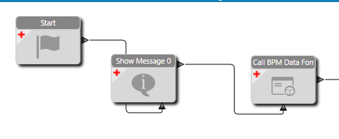

See if this screen video works. I am passing part and rev as shortchar01/02 from the dashboard to be used by the BPM. The message box are the CallContextBpmData values before the BPM Form call.
