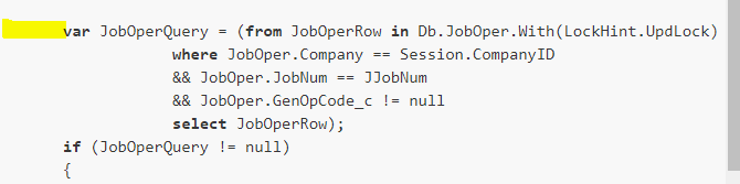

Try this
Erp.Tables.JobHead JobHead;
Erp.Tables.JobOper JobOper;
Ice.Tables.UD02 UD02;
using (var txscope1 = IceDataContext.CreateDefaultTransactionScope())
var firstJobHead = ttJobHead.FirstOrDefault();
string[] SaveGenText = new String[5000];
if (firstJobHead != null)
	var JJobNum = firstJobHead.JobNum;
	var JGenOpCode = (String)null;
	var JobOperQuery = (from JobOperRow in Db.JobOper.With(LockHint.UpdLock)
				where JobOperRow.Company == Session.CompanyID
				&& JobOperRow.JobNum == JJobNum
				&& JobOperRow.GenOpCode_c != null
				select JobOperRow);
	if (JobOperQuery != null) {
	foreach (var JobOperRow in JobOperQuery) {
	        var UD02Record = Db.UD02.Where(x => x.Company == firstJobHead.Company && x.Key1 == JobOperRow.GenOpCode_c).Select(x => new { x.GenTxt_c }).FirstOrDefault();
	        if (UD02Record != null) {
	            JobOperRow["JobGenTxt_c"] = UD02Record.GenTxt_c.ToString();
Db.Validate();
txscope1.Complete();

I honestly never looked at the code, just fixed the mistakes. :slight_smile: I would do a few things different.
Mr Edwards – you nailed it!
Thank you very much for fixing the syntax.
It works like a charm!
