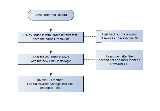

When I change the OrderHed row and want to update the child OrderDtl rows, how can I do so in a way that still triggers things like tax calculations on those rows? Will getting the rows through db, updating and validating them work? I kinda thought that would circumvent the update logic.

That sounds reasonable. So, would this workflow be correct?
This is the shell of what I ended up with using BOs.
this.CallService<Erp.Contracts.SalesOrderSvcContract>(bo =>
  var ds2 = bo.GetByID(this.iOrderNum);
  foreach(var line in ds2.OrderDtl){
    // Logic to calculate and set line.DocUnitPrice and line.RowMod
  bo.Update(ref ds2);
