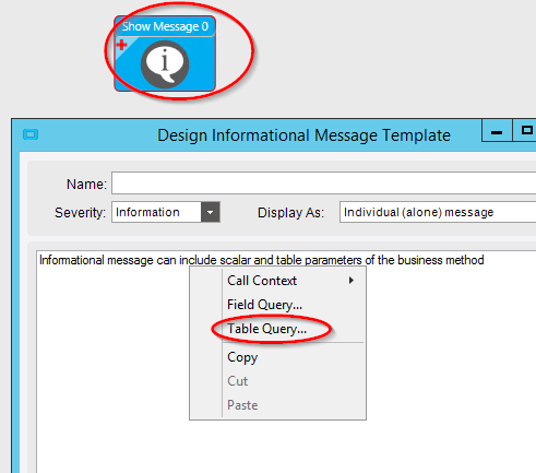

To actually “See” the records, use a Show Message widget, and inside that, you can display the values of the records that are available in the BPM Dataset. image
