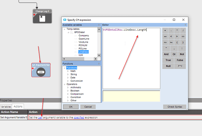

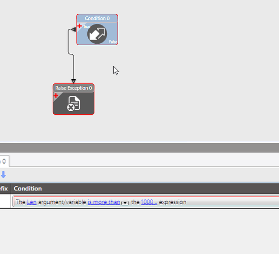

Data Directive on PODetail is your best bet here I would put an In-Transaction Data Directive
with a condition where PODtl.LineDescription.Length > 1000 then throw an exception;
Create a Variable of type Integer
Then assign it the value of the Length of the LineDescription field
then add a condition that if the sepecified parameter > 1000 then throw exception
