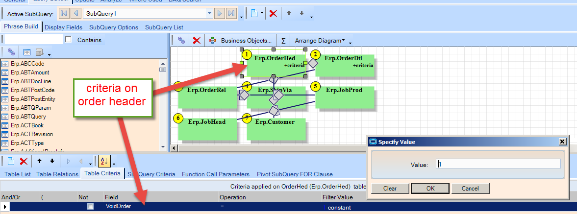

Are you certain your error is not with your “and” criteria? I just checked in the BAQ designer for 10.1.600.5 and it works using constant of 1 for the boolean checked compare , per screeshot below.
Nancy
As I said in my initial post, this does work fine in the BAQ designer. The BAQ designer generates SQL code, and 1 works as a value in SQL with booleans. The query designer for BPMs looks a lot like the BAQ designer, but that operates on C#, which not only requires the “true” value for booleans, but is case-sensitive as well.
