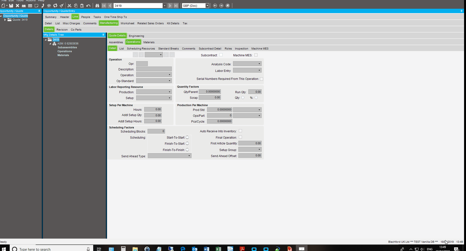

We do use Pull\View As Assy for some parts but that was all tested for MRP\Vantage at implementation stage over 10 years ago. If I add the part on E10 as a Sub-Assembly on the Quote rather than a material it all looks to work more how Vantage does, so I just wondered if it was an E10 change. Screenshots below:
Can you make a video or gif of your process so we can see what you are doing? (Screen to gif is a handy free program that will do that for you). I think you are doing something incorrectly, but I would like to see what steps you are doing.
Thanks for your help. This is exactly how we do it in Vantage so would appreciate knowing how we need to work correctly within E10 (apologies for the quality of the video).

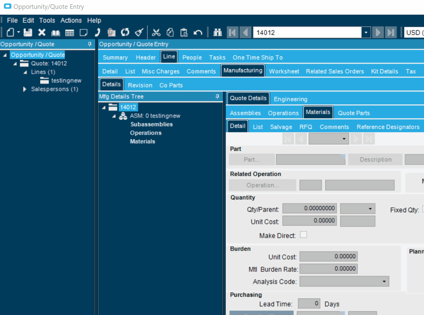

From @tmat’s post with the two screen shots, it looks like they are starting with a BOM that is pulled in with Get Mfg Details, and then wants to add to it. And the act of adding to it removes the details (at least the materials) from the orignal Get Details.

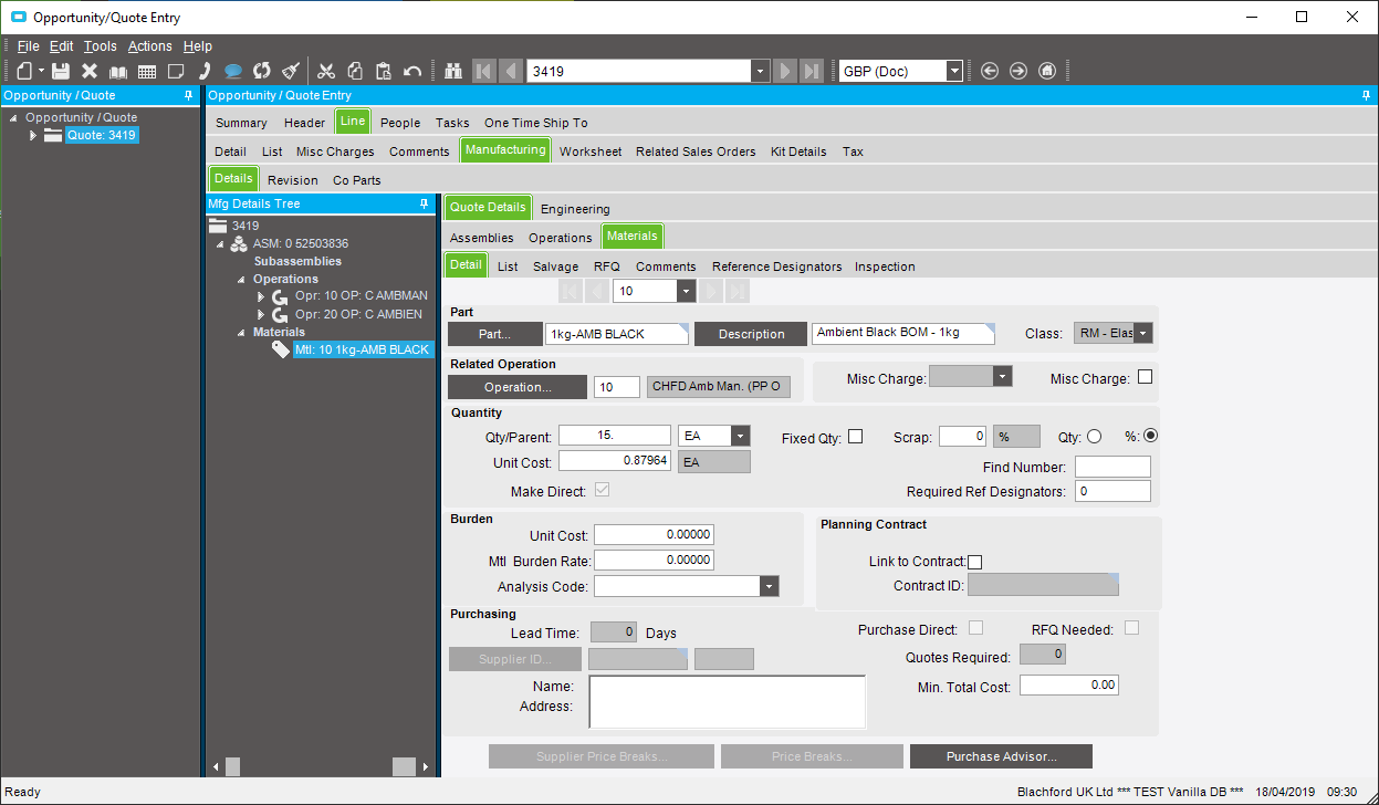

Yes, that looks the same as we use in Vantage… add as a material and show the part number (not the materials within the sub-assembly). We are on 10.2.300.8 so I will have a look to see if I can see a setting. Thank you!
We are just adding a material, exactly as Brandon shows on his screen clip. I think I need to have a look through the settings, unless it is a change in 10.2.300

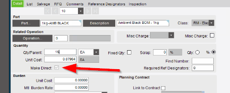

It is set up as Non-Stock as theoretically it can never exist… the material is created when we inject a pre-made mix of chemicals with another and the material then sets to form the product. The parts are setup exactly the same in Vantage and E10 though.
