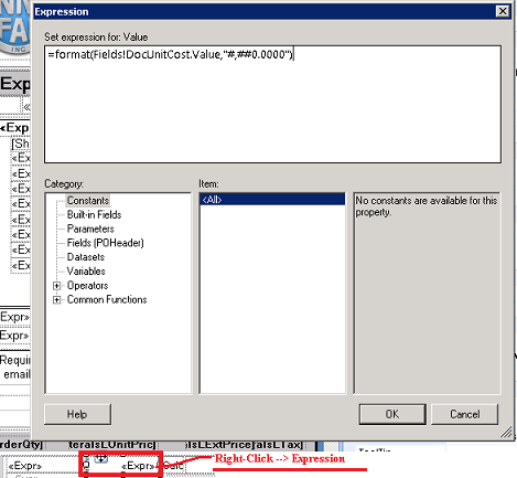

Yes, sorry, I assumed you already had an SSRS report loaded in report builder.
Once you are in the editor, you can Right-Click on the fields to see the expressions, data source, formatting.
Thank you all! what I did was override the default by changing the field properties from custom to numeric and setting the desired length, and it worked.
