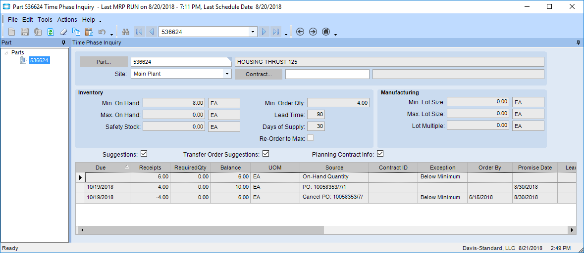

We are seeing dozens of PO Change Suggestions to cancel orders that were created to cover a minimum stocking level. Here is the Time Phase screen from one part as an example.
The part has a min of 8, there are 6 in stock, and an open PO for 4 pieces, which is the minimum order quantity. We cannot understand why the system would tell us to cancel this when it recognizes we are below the min. Is there a setting somewhere that we have missed? Any help or suggestions would be appreciated!

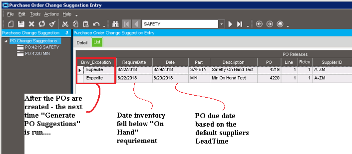

In the past I have created custom BAQs/Dashboards so I can filter how I display the different types of Change Suggestions.

The data looks a bit funky as what is happening here is that you have an actual po (not a suggestion) that was raised on the 16th June 2018 promised to arrive by 30th August but it has not been received yet - as you have an open po it cannot make a suggestion - what it is suggesting is cancelling this overdue actual po - the source is the tell tale - if it was a suggestion it would say suggestion in the source field.

The system is suggesting that we cancel the PO because it thinks it is Surplus. The PO was created to cover a Minimum Stock level, and there is a minimum order quantity as well. So, when the system planned the New PO Suggestion, it told the buyer to buy 4 pieces, per the Minimum Order Quantity. The current BOH is 3, the Min is 4, and the PO is for 4 pieces. We are going to get three more pieces that what is required to cover the Min, so that is probably why the system “suggests” we cancel the PO.
