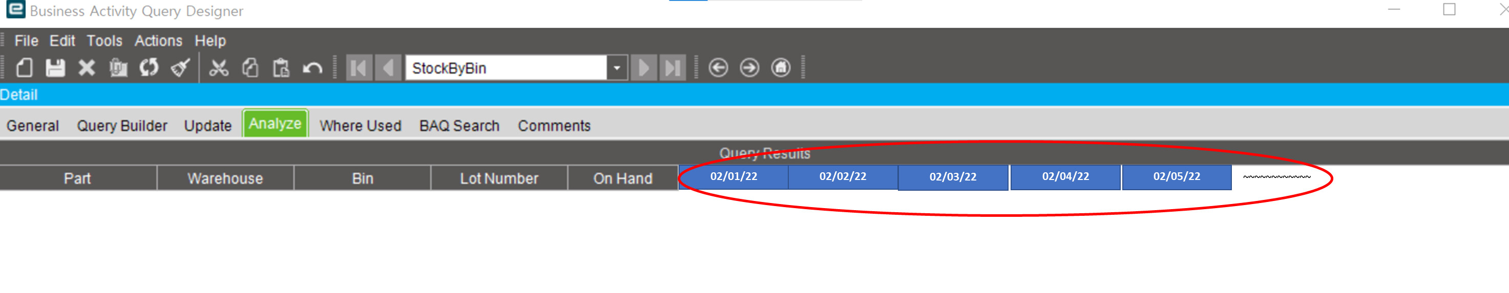

We manage inventory on a bin basis. So, it is necessary to manage the change in the daily bin stock quantity.
I created Bin’s on-hand Qty. But, I want to make it so that the quantity by day can be managed like the picture below.
Is there any way to do it? I need the help of BAQ experts.

Yes. I just want to see how much stock was in the bin by date in the past (by part).

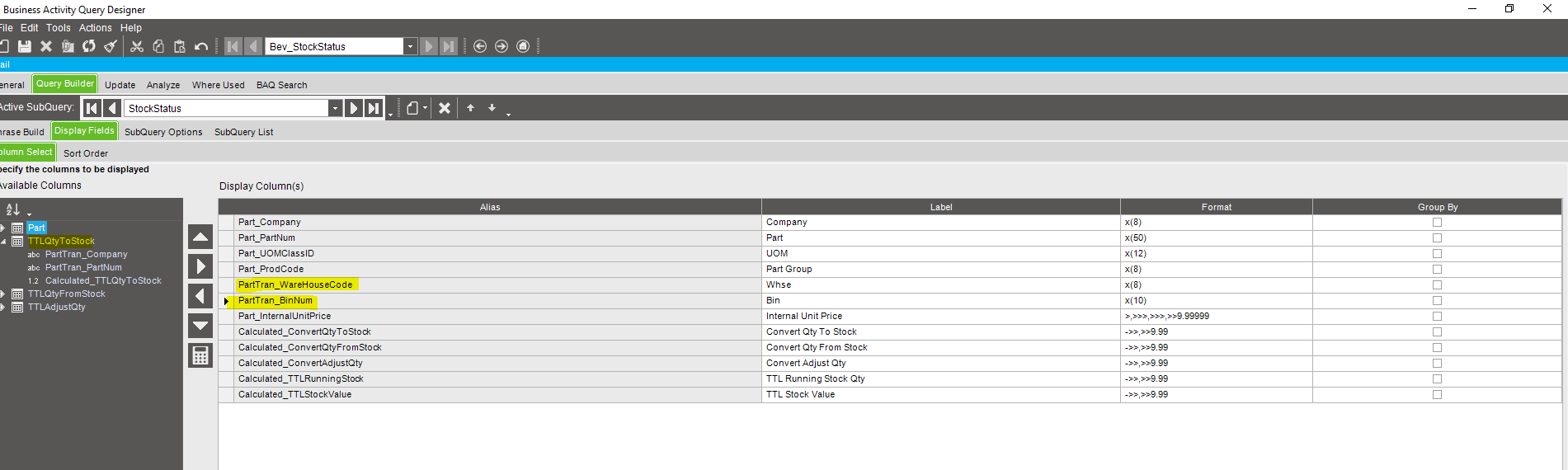

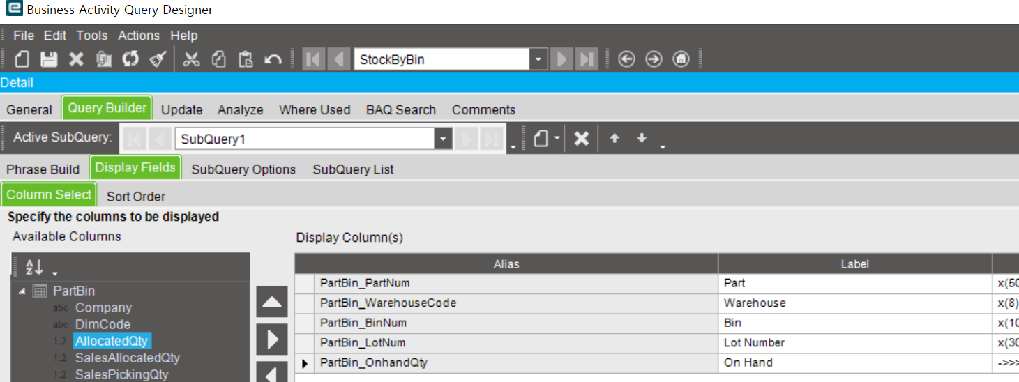

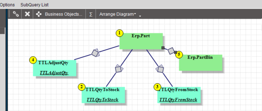

I made a BAQ from the query you advised. And then I imported PartBin to add Warehouse/Bin to column. This is because even the same part is distributed across multiple bins. However, they appear as duplicates in multiple bins. What should I do?
Can I set the parameter to duration other than Cutoff? In that case, is the calculated quantity calculated as the quantity for the period? Is it calculated over the entire period?
Any help would be greatly appreciated.

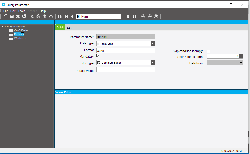

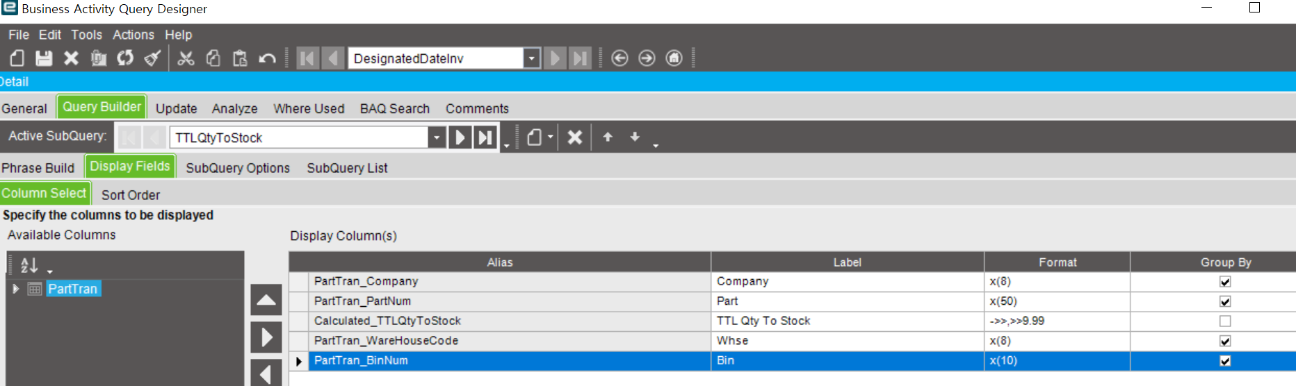

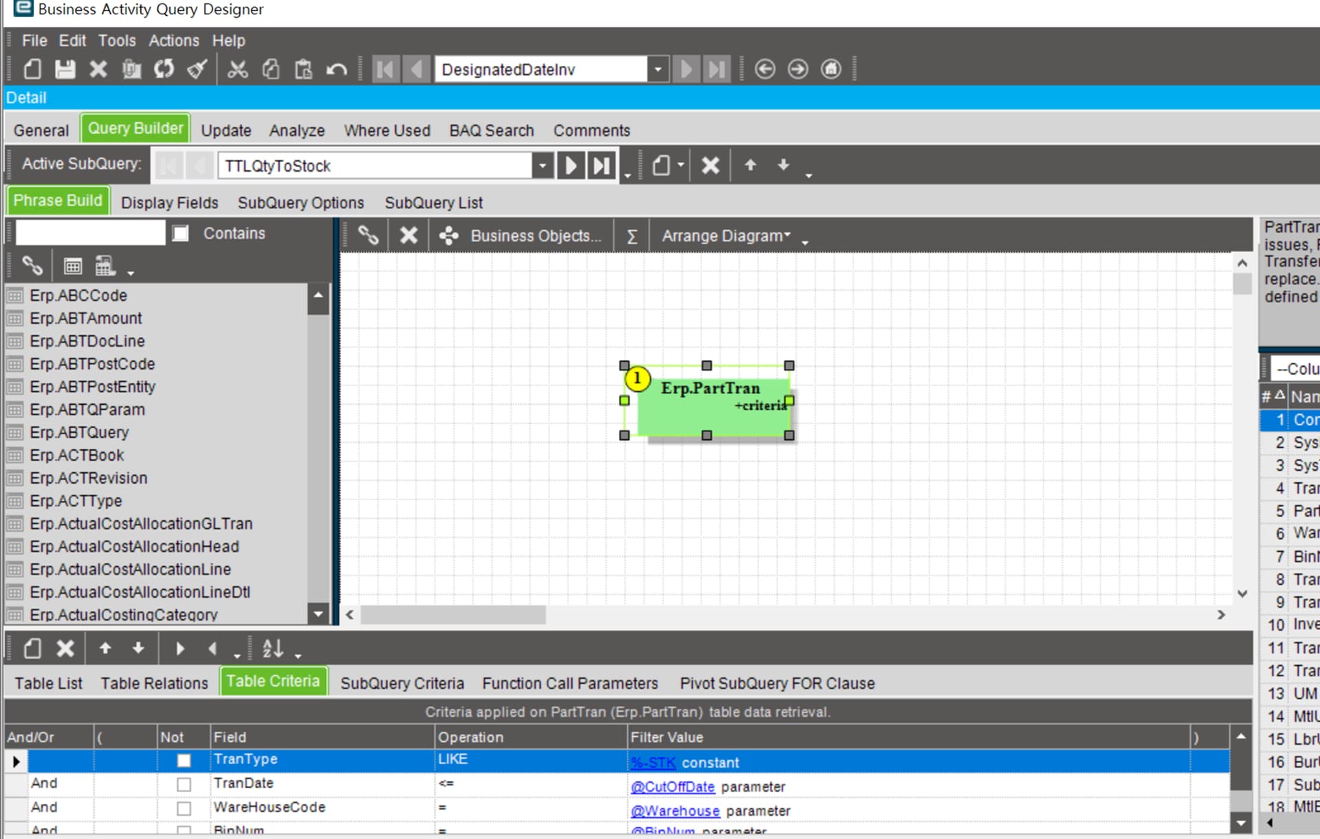

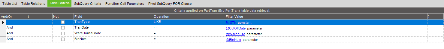

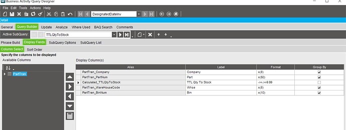

if you want it to be Bin specific, then yes you need to add this to each one of the three subqueries as a field to group in by, then added it as a dynamic filter same as the cutoff date, (i.e. remove it from the top level), however this will only count the stock within each Bin not as total, e.g. you could have zero on Bin-1 but 100-off in Bin-2, thereby your BAQ want show it when Bin-1 selected.

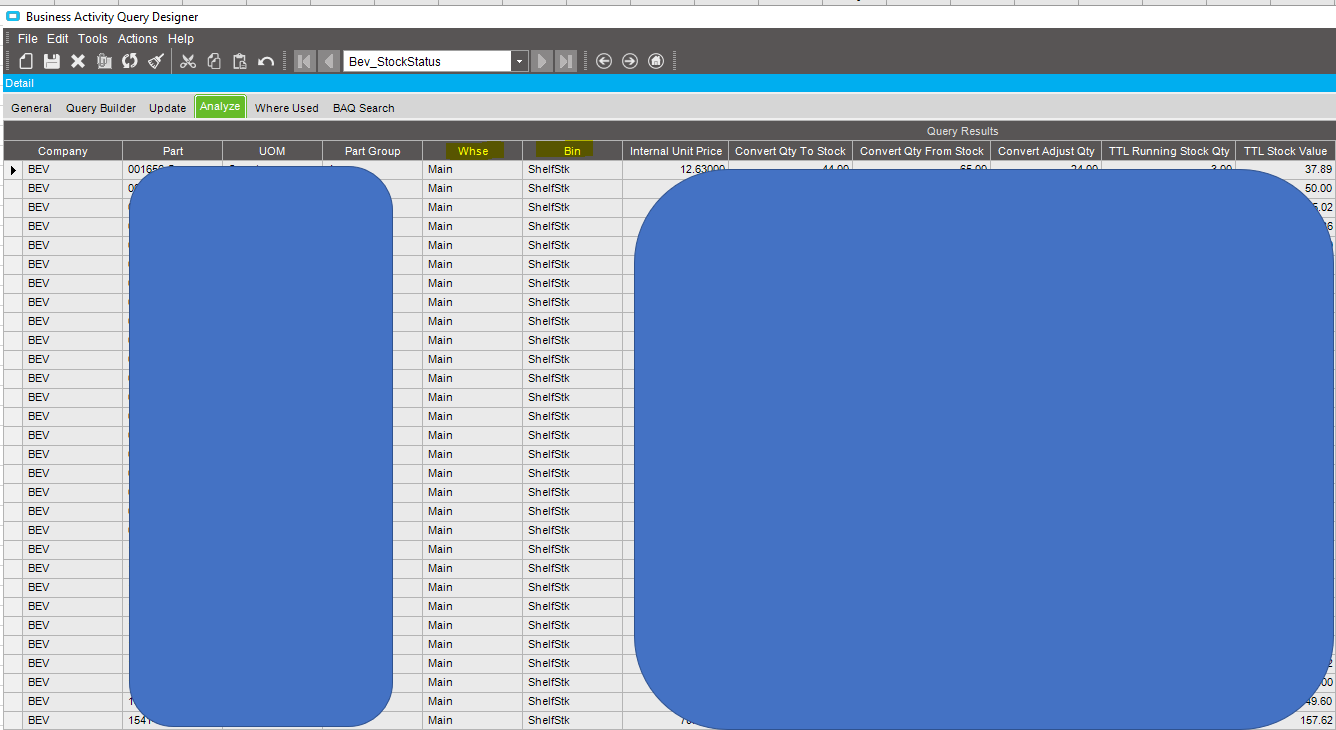

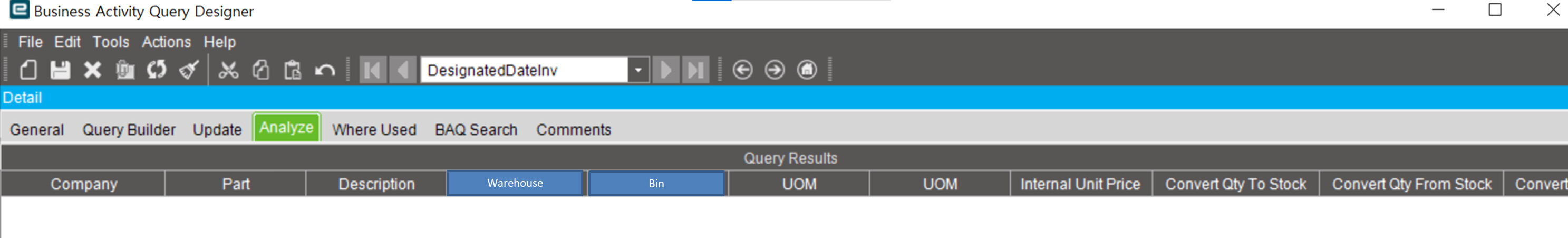

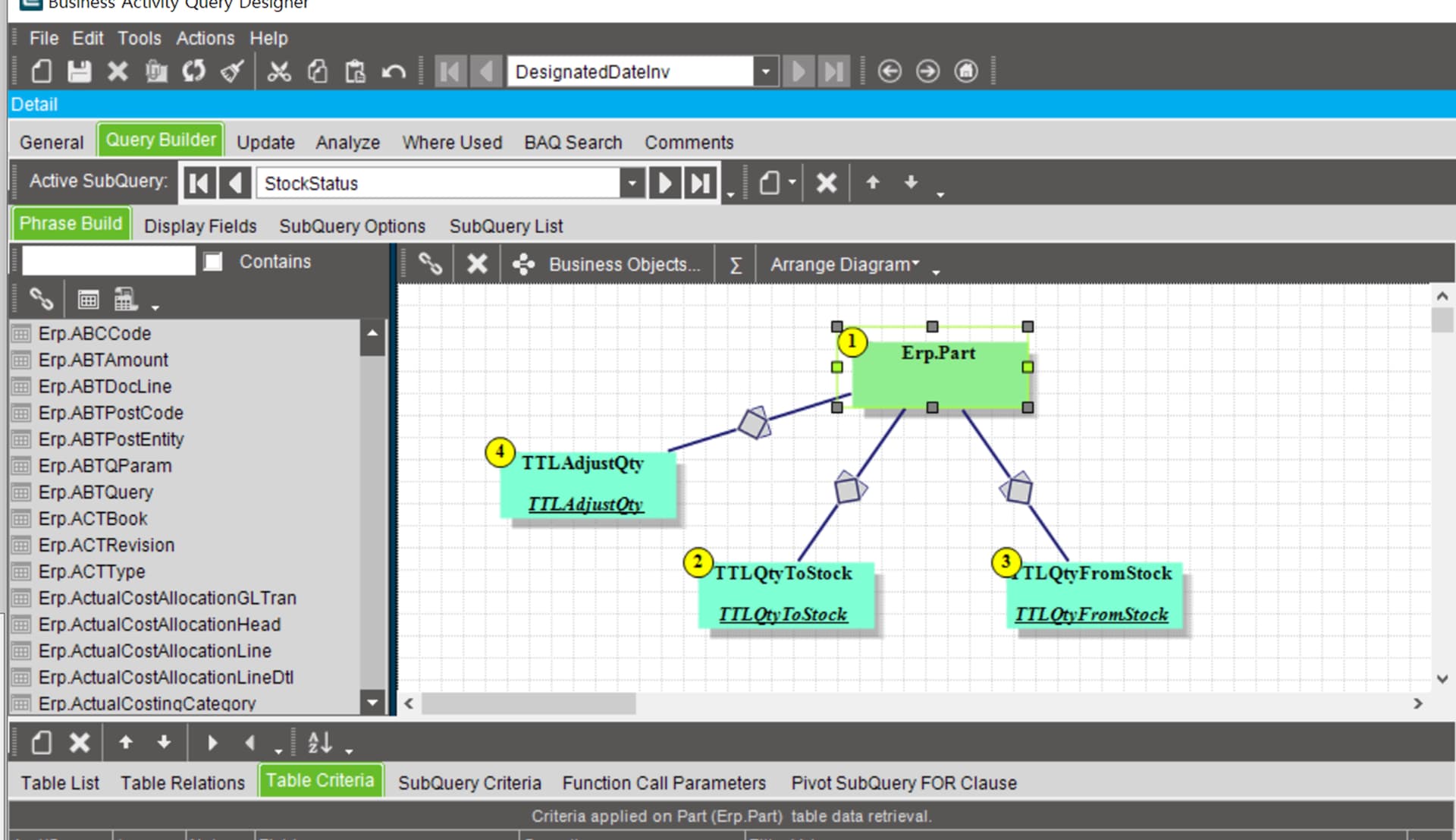

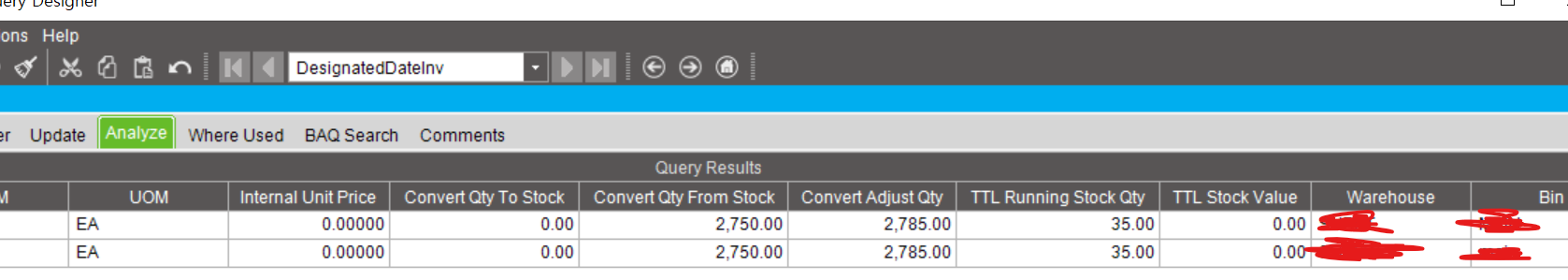

As per your advice, the fields are complete, but the data doesn’t match. The result is an entirely different number.

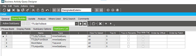

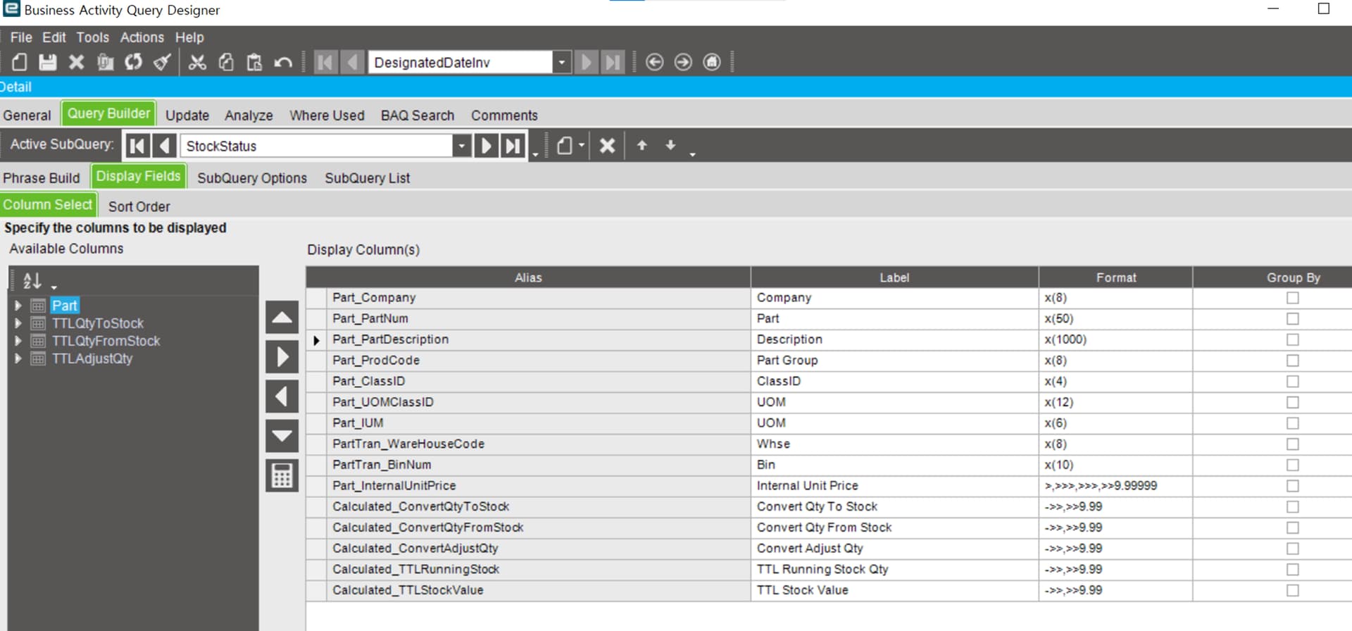

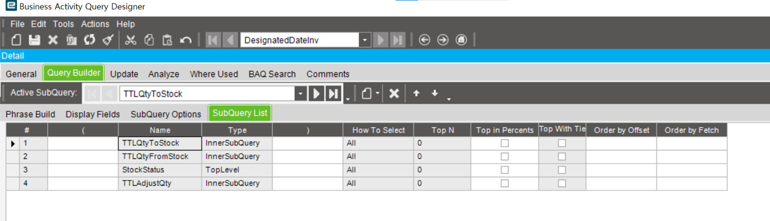

I don’t know what’s wrong. I have attached my BAQ screen, can you please check if there is any problem?
it is working in my environment, but without an example of the wrong data it is hard to determine, and to do this investigation select a part that you know it goes to different bins and calculate the running total on part transactions history up to specific date, specific bin, specific warehouse, then compare to be able to say
are you running it for multi company ? if yes, again you need to add it the same way as other parameters
