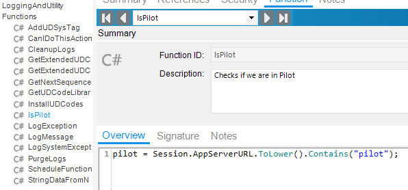

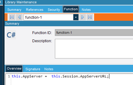

Currently we need to be very specific on the customer URL content, as Dedicated Tenancy URLs have really nothing to identify Prod other than the “/SaaS999/” string vs. “/SaaS999Pilot/” string, while for Single Tenants we can find the “-live.” string vs. “-pilot.” string.
It’s not clean in the way to get the right answer, and i definitely hate to rely on a URL structure that could change over time…
You do have fields for “IsLive” available, that will tell you whether or not you are in a live environment or not. But for knowing the specific instance, the URL is going to actually be the most reliable way to know which instance you are connecting to. “Pilot” “Train” “Education” “PurpleMonkeyInstance” are all arbitrary names that could also change at any time.
