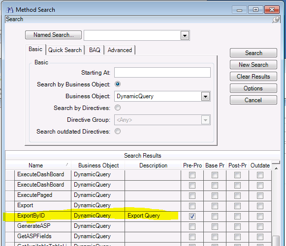

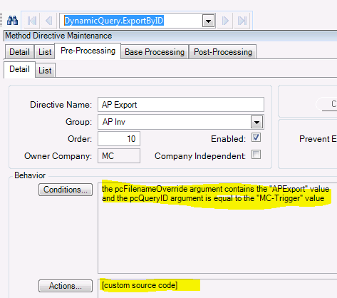

In V8 I put the code in a DynamicQuery.ExportByID BPM. Then scheduled a BAQ Export Process.
Conditions:
the pcFilenameOverride argument contains the "APExport" value
and the pcQueryID argument is equal to the "MC-Trigger" value
But in E10, there is no DynamicQuery.ExportByID

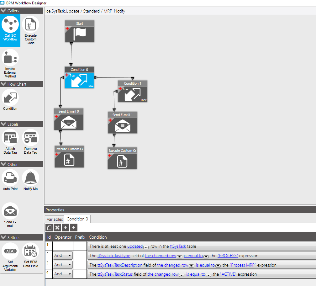

I am by no means broke into the ‘best practices’ aspect of E10 but I can tell you how I’d do it. If your schedule isn’t too picky and you can piggy back it on something else already scheduled, that could be easy. For example, let’s assume you had MRP running daily, you can create a DATA DIRECTIVE on the SysTask table and use a condition to look for only MRP events (and only starts, not completions - see screenshot)
