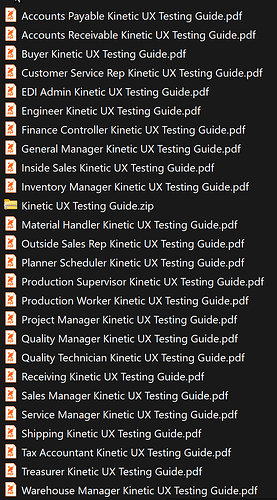

I also found on EpicWeb testing guides by various roles

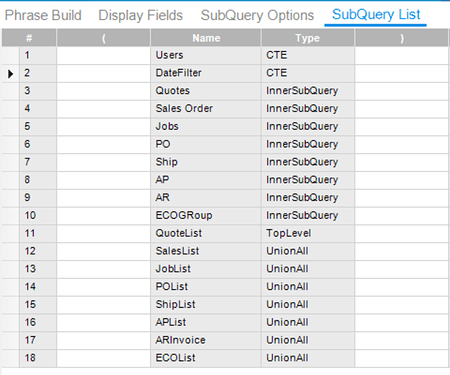

I have been using this since 2012 - every implementation and testing scenario it’s been in place.
If you change the date range to be dynamic to just last month it gives you a sense of the amount of transactions each user is doing.
Interested in any improvements - would like to have a kinetic with charts in the future.

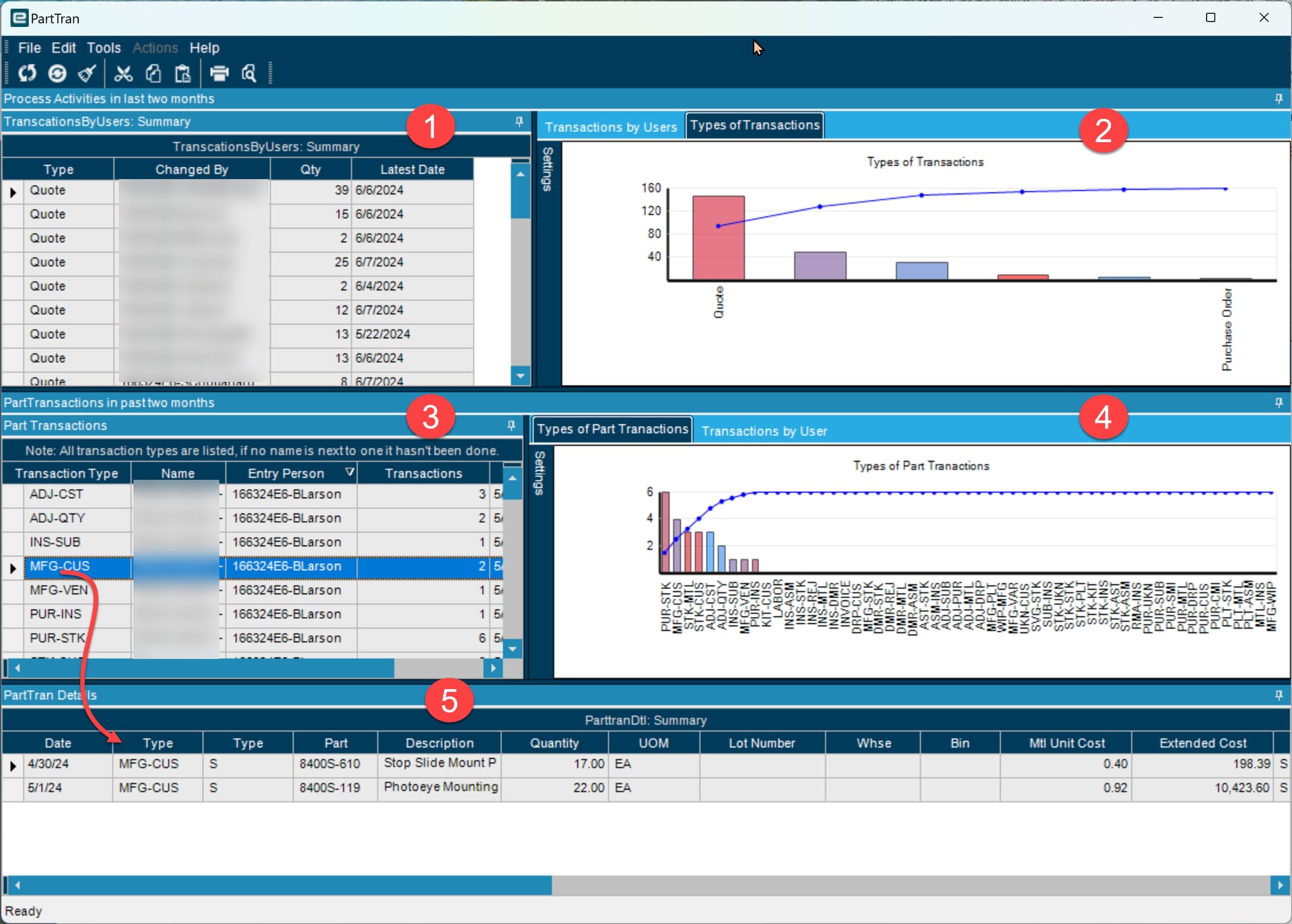

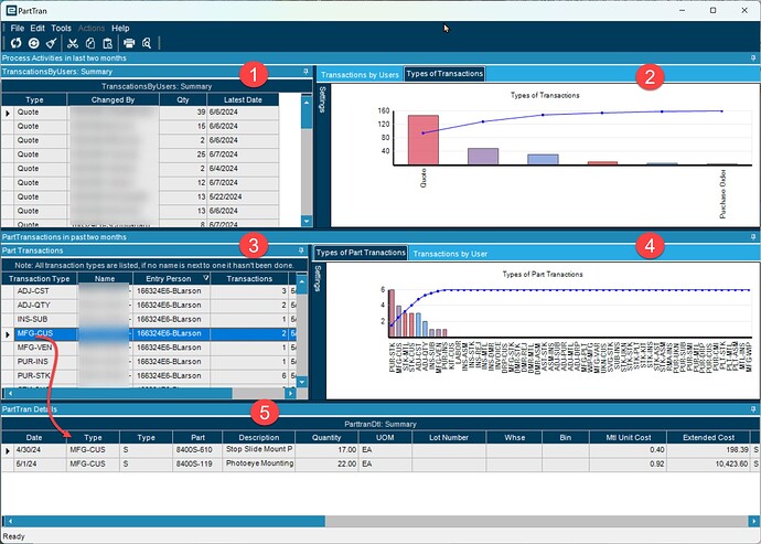

Here’s a shot of the dashboard
  1. Type (quote, po, ar invoice, …)
  • Type
  • Changed by
  • Qty of transactions
  • Last Date
  1. Showing a pareto chart
  • charted by Types of transactions
  • charted by user

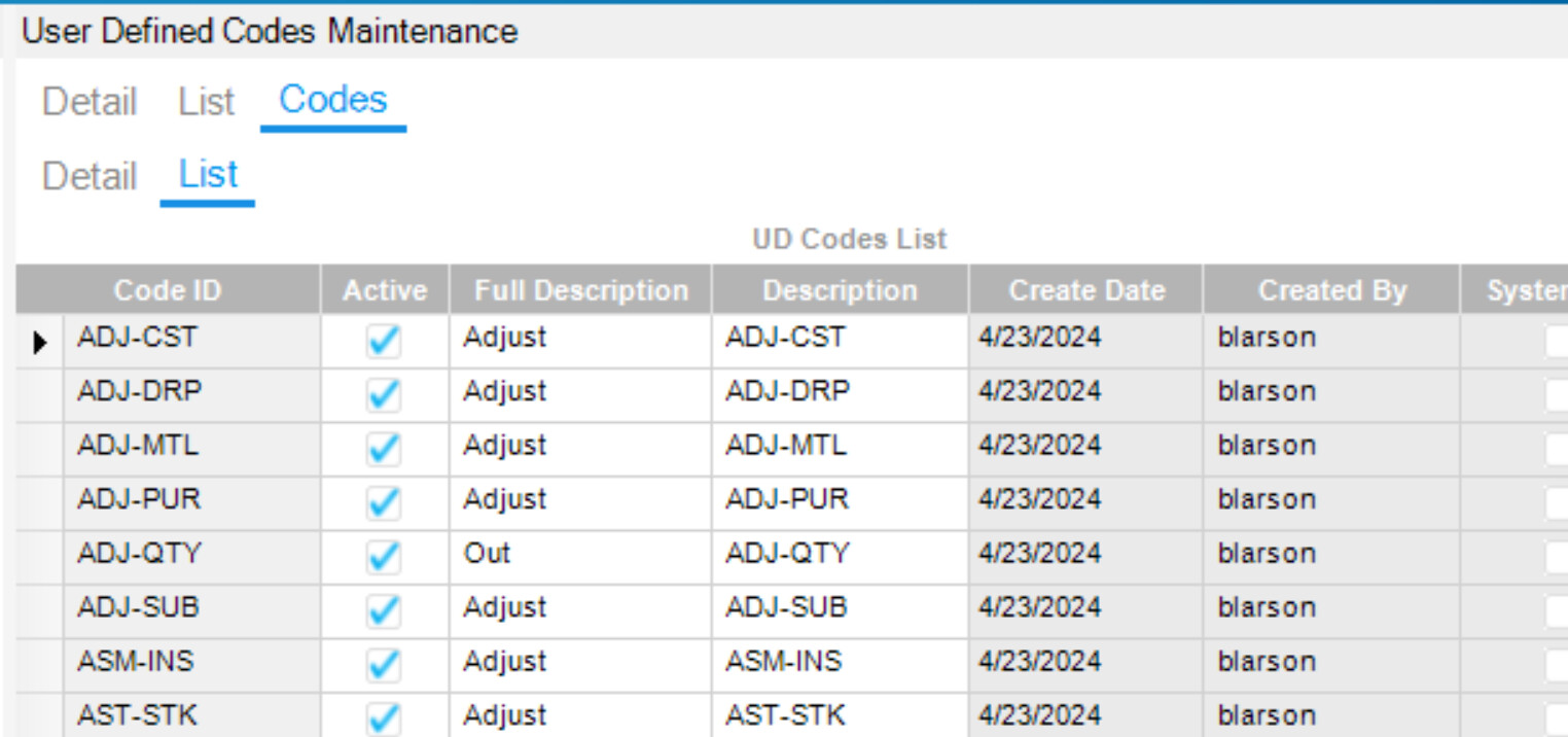

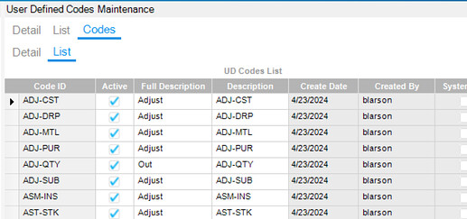

  1. Part Transaction (Parttran table)

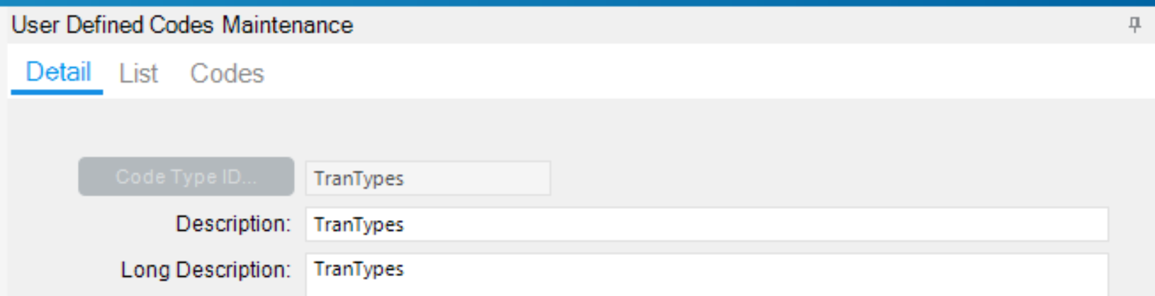

    I have a usercode table setup that lists all possible transactions
    This will show if certain types of transactions haven’t been done
    If you don’t upload the user code table - nothing will show.
  2. Chart of the actions by type and user
  3. Details of the transactions done by the
The subquery Datefilter (with no table) is a fixed date range that the other subqueries use to select the transactions.
The userCode - TranType - You must load this table for the parttran BAQ to work
TranTYpes_Place in UserCodes.xlsx (14.4 KB)
