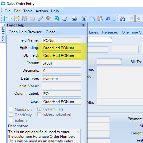

Easy tip for those who know, indispensable for newbies:
Use field help technical data to understand where your data lives; this’ll be important for queries, reports, bpms, customizations, etc.
That’s a great tip for new power users. Also, if the DB Field box is blank, that means it’s coming from a view and not directly from a DB table.
Regular uses will get more out of the field level help:
