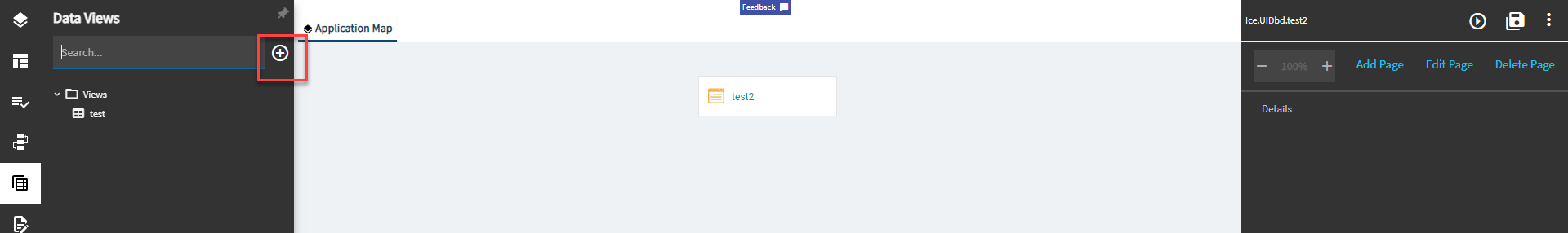

Basic Application Wizard no TransView
The Basic Application Wizard looks like a great place to start for a new screen, but the base screen doesn’t have a TransView. Did I miss something when generating the screen or can it be added?
It’s a runtime view; you’ll never see it in App Studio, but it’s “there”.
You can assign variables on the fly without having to define the view.
It shows in app studio on a normal screen or a deployed dashboard.
But in a screen created with the application wizard it’s not there.

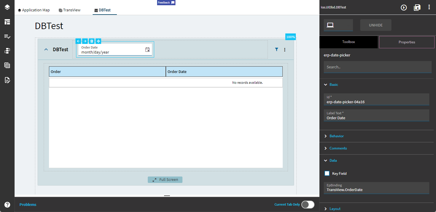

Here’s what I did on the dashboard:

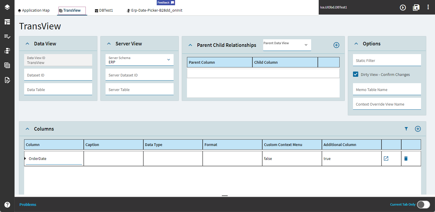

Add a column to TransView.
Add a date picker and bind it to TransView.OrderDate.
Update the where list in the grid provider model.
The result is great. It refreshes as soon as you update the date and feels cleaner and faster than a classic dashboard.
For the page created in the application wizard I did the following:

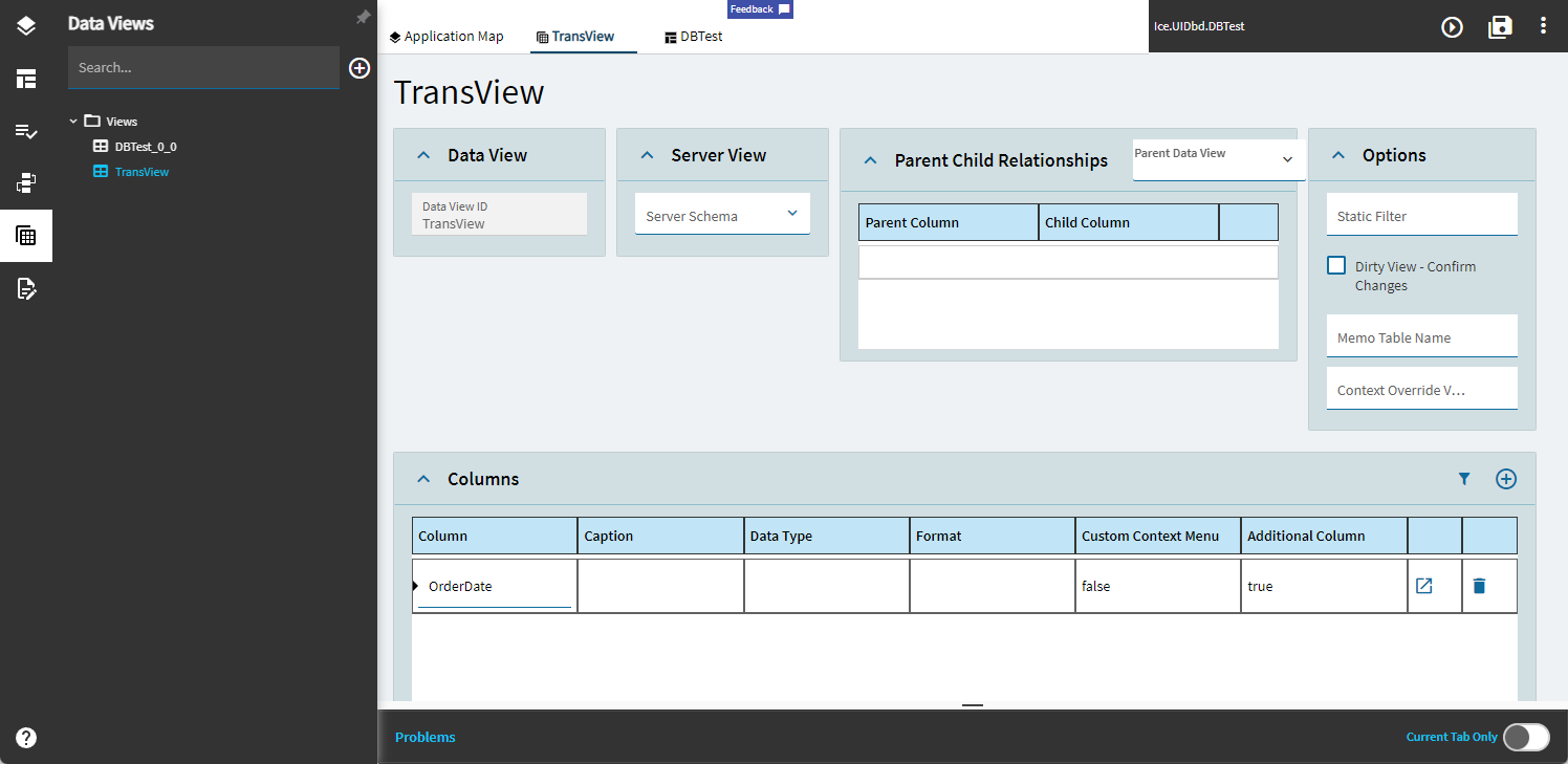

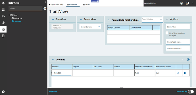

Added a TransView and gave it a column OrderDate
Added a date picker and bound it to TransView.OrderDate

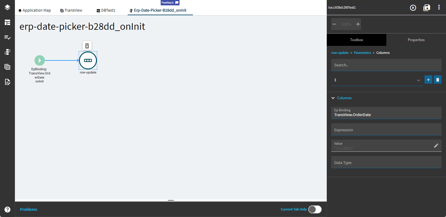

Added an event on create of the date picker calling row update and gave it a default value.

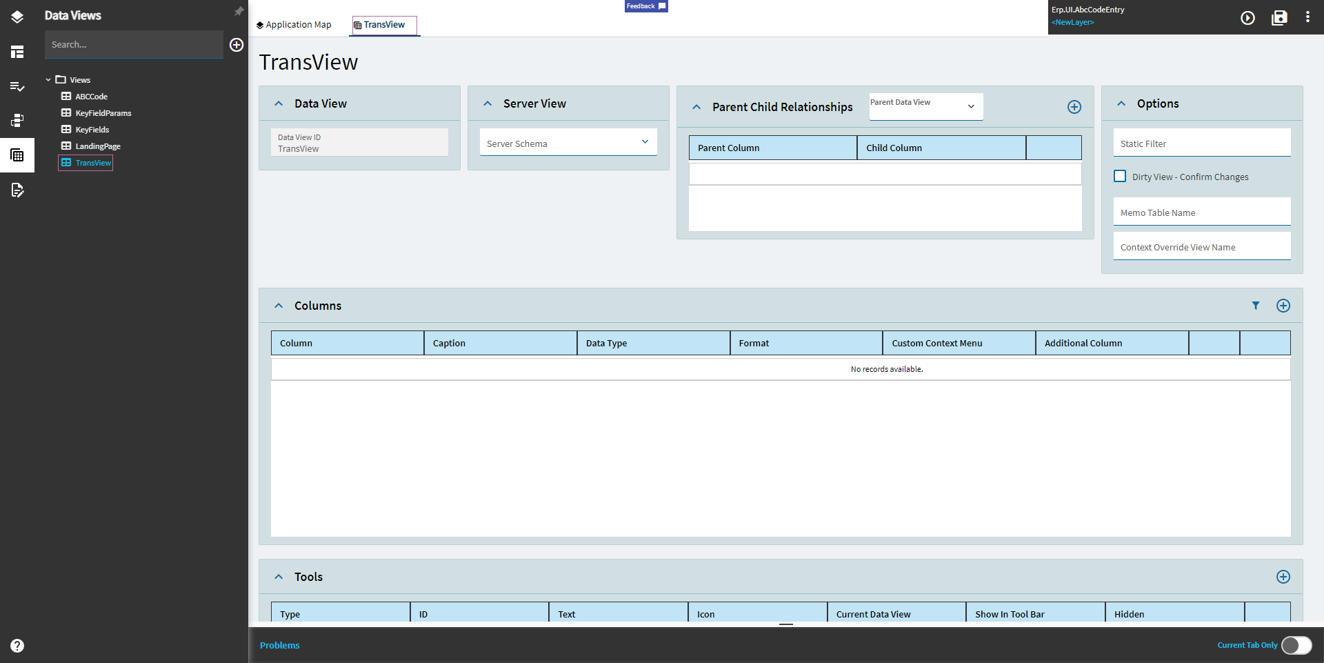

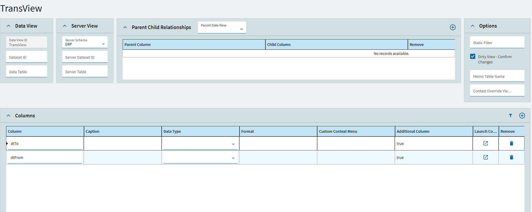

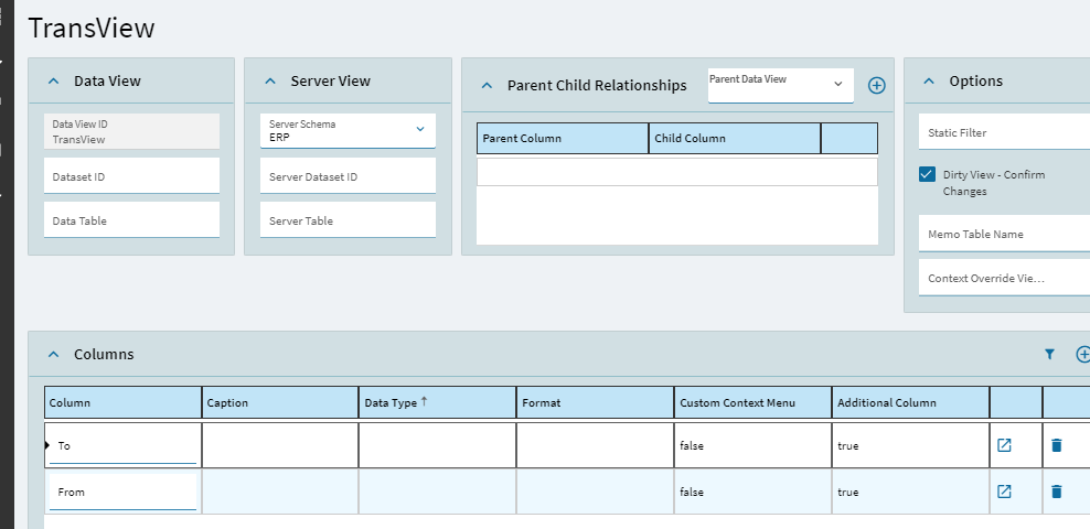

I didn’t think I would need to or be able to create the TransView the way you described, but when i bind my date pickers to TransView.From and TransView.To they appear disabled:

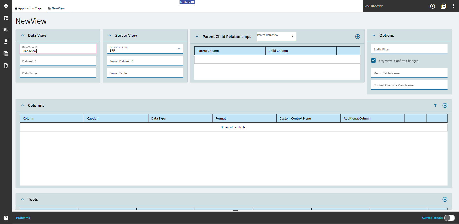

When I add the TransView myself and try adding those columns, it won’t let me set anything more than Name, ie cant set Data Type, and my date pickers are still disabled:
Looks like adding the onCreate to the date picker and initializing the date (as you did above) kicked the machinery into gear!

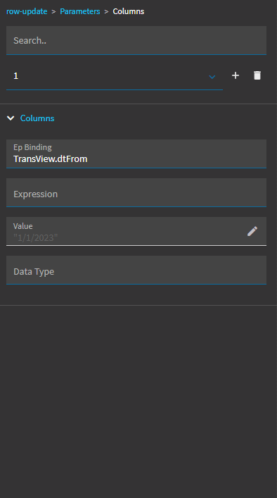

Learning Kinetic customizations here and stumbled upon this post in a very similar situation. I’ve created the Kinetic application through the wizard, added the TransView manually, and began following some of the process’s others posted previously.

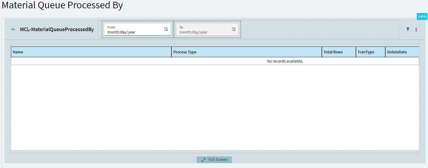

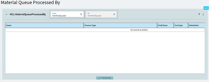

Whenever I run the dashboard & choose a date based off the ‘From’ date picker, I get returned no results. I’m imagining I am missing something basic or key to make this function. I currently disabled the ‘To’ date picker in order to try filtering based off a single date for now.
Dashboard:

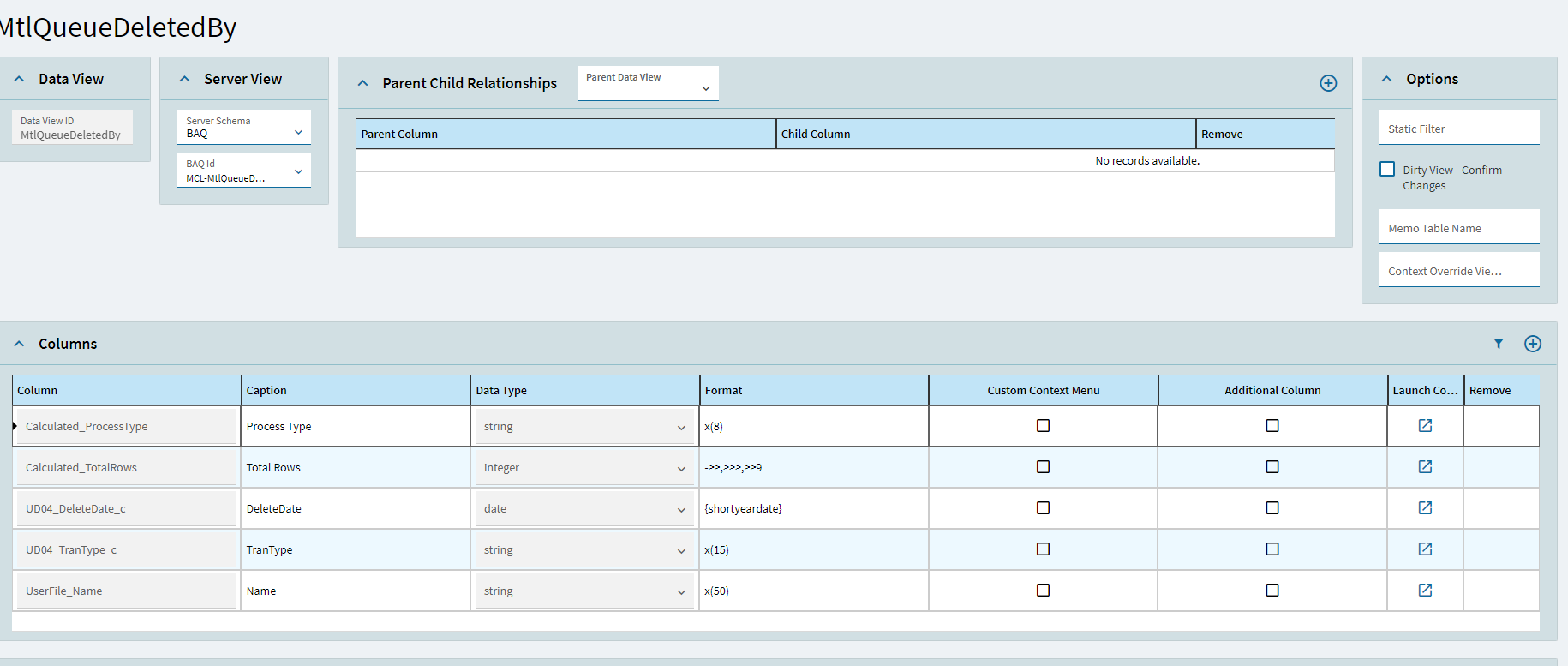

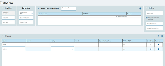

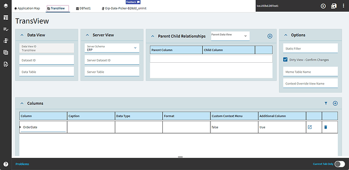

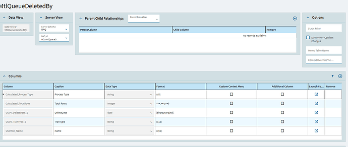

Here are both my data view with the BAQ & TransView:

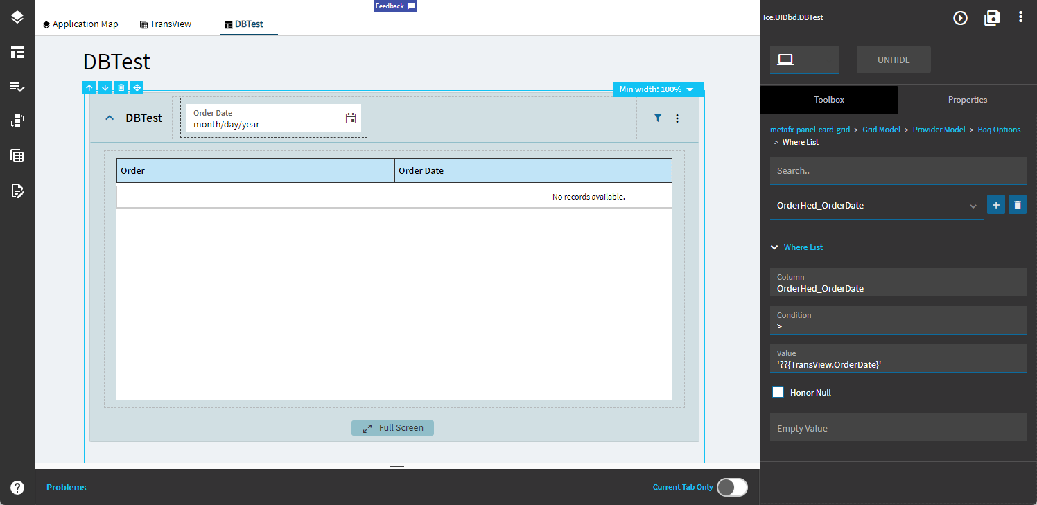

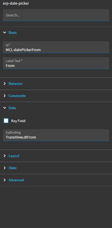

Here is data picker binding:

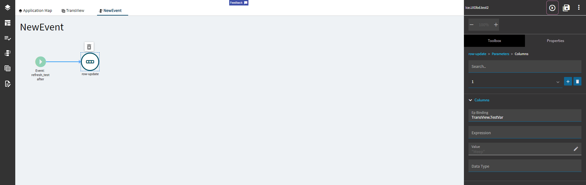

Date Picker onCreate for a row update:

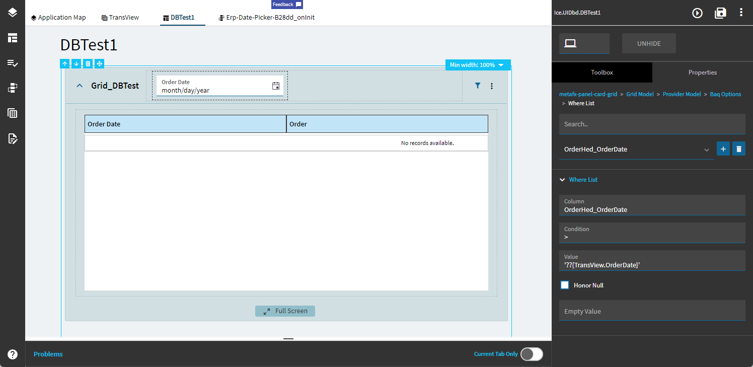

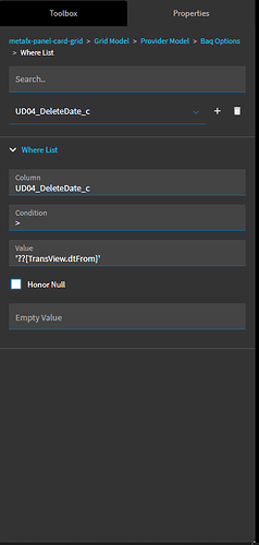

Finally, the where list for my BAQ field I wanted to filter off of:
Thanks for any tips or help!
Remove the single quotes from your date filter: ??{TransView.dtFrom}

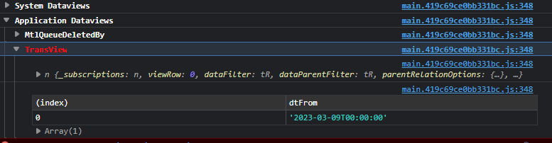

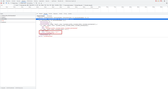

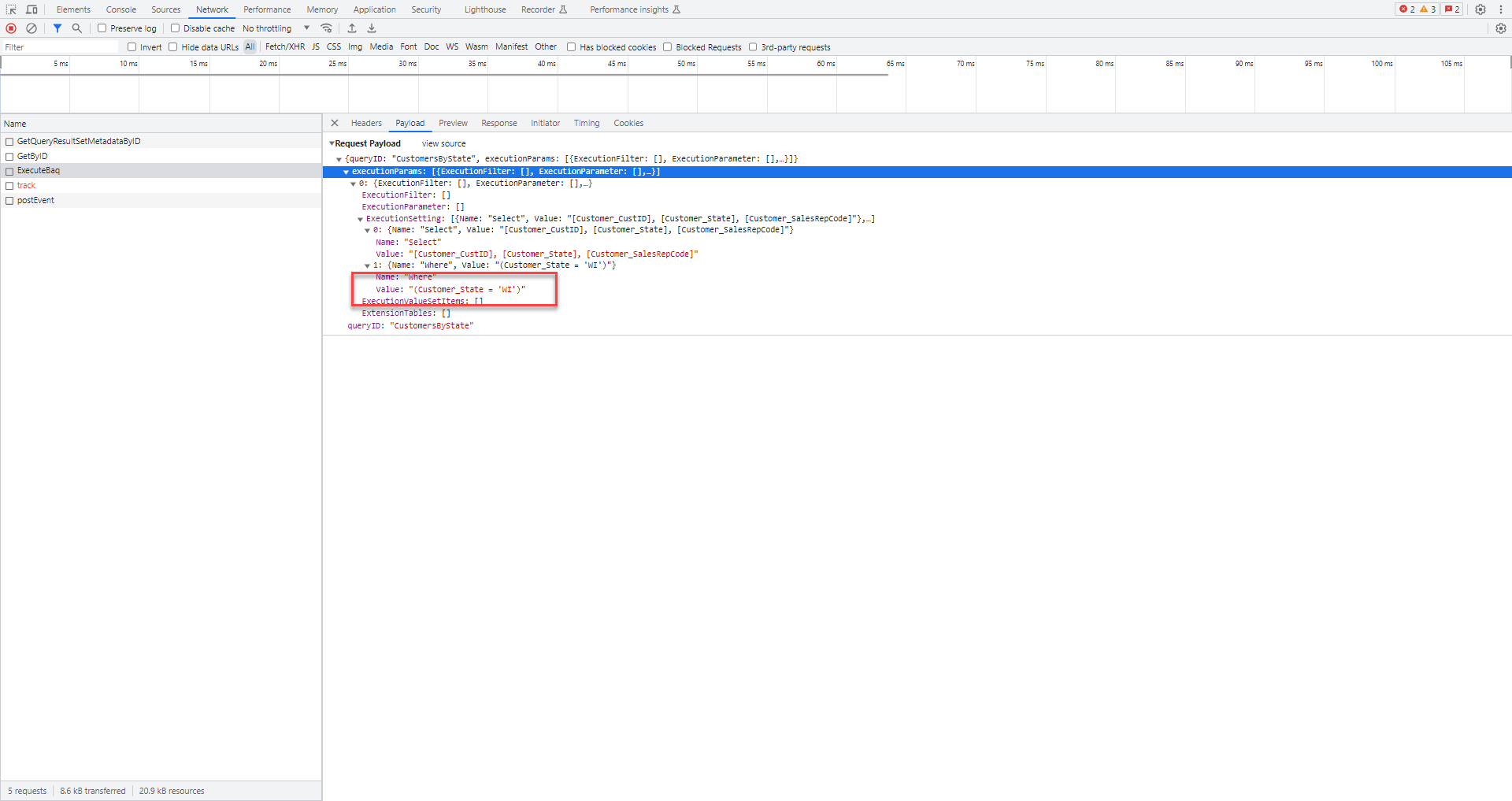

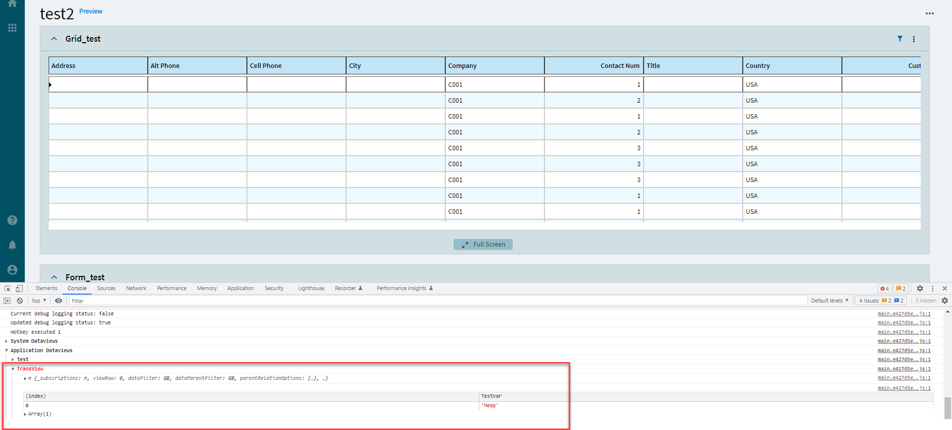

Check the network tab of Dev Tools to see what it’s passing for filters.
Heres what I found:
Maybe I need to format my date filter to shortdate data type to match column settings? (just a guess)
Another parse error before turning on Epicor debugging:
Set your value to 2023-1-1 instead of 1/1/2023.

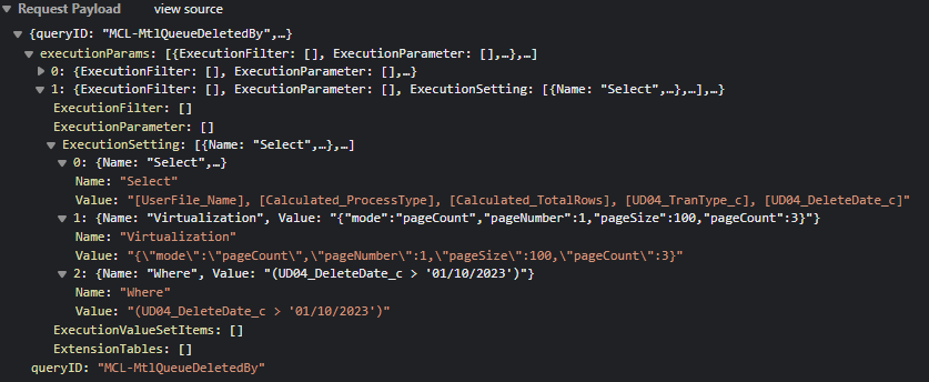

Look at the network tab as well, though. There should be a REST call in there.
You should have some rest call (Not necessarily an ExecuteBaq) that has filters. This will show you what it’s sending and you can diagnose from there.

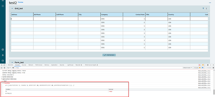

It looks like a date is being passed. Thanks for your continued help by the way. :sweat_smile:
Does the Network > Results tab show anything for that call?
If you enter that same date in your BAQ manually, does it get data?
