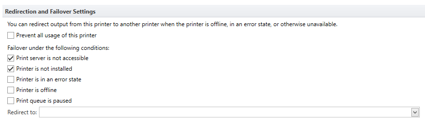

Yes. We are using print command script with %EventData%. Is this what tells bartender to use the printer listed in the label file that is generated? Can some other setting override the %EventData%
I believe the label data can be overridden based on the information in the Administration Console, There is a Printer Setup page and in that page it does have a redirection option when the printer is offline, in an error state, or otherwise unavailable.
