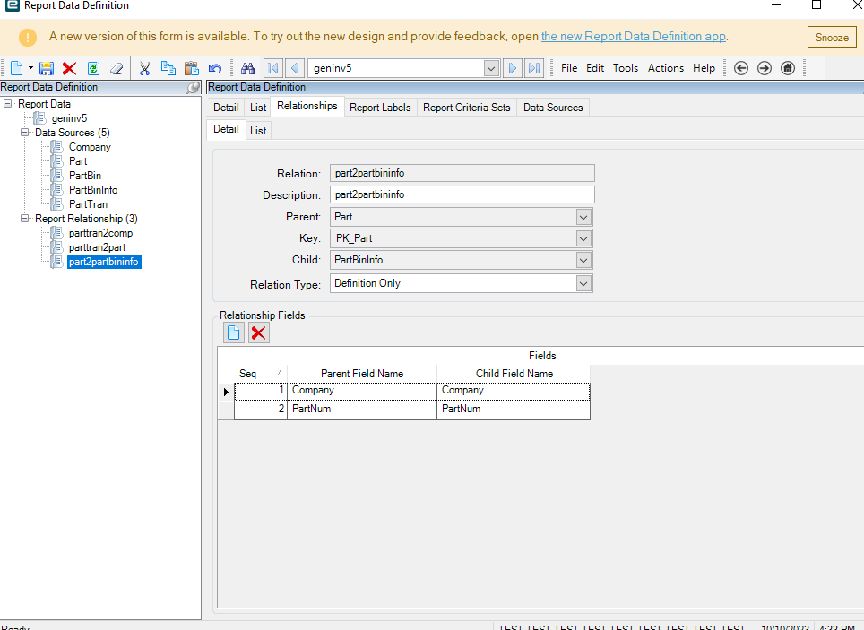

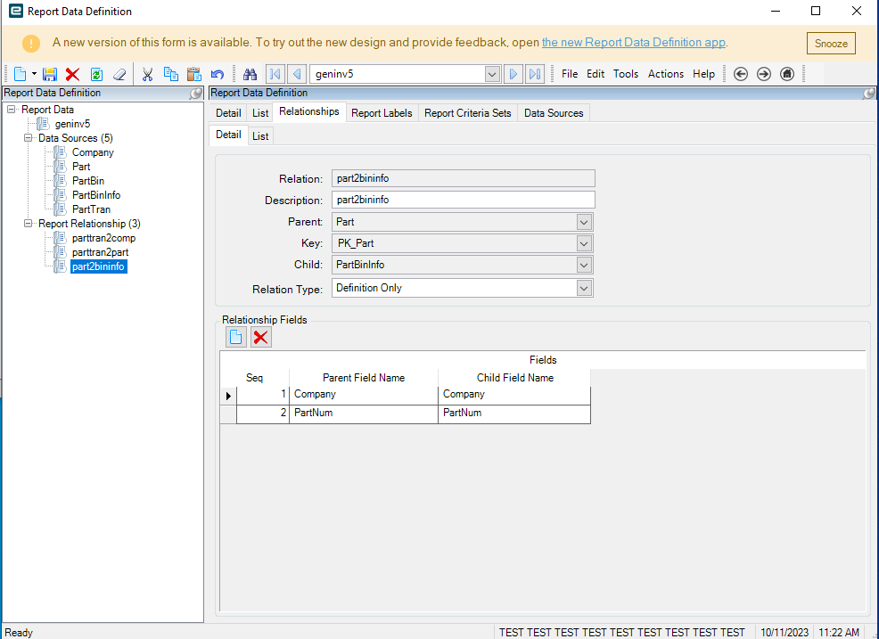

Hi @andrew.johnson ,
when I join partbininfo to part with relationship type as definition only.
the last fields are blank

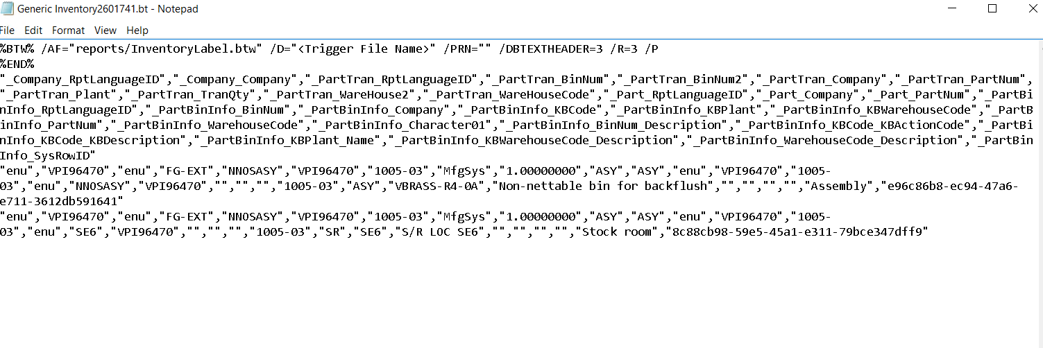

and when I join with relationship type as output, I can pull all the fields but the there are two records

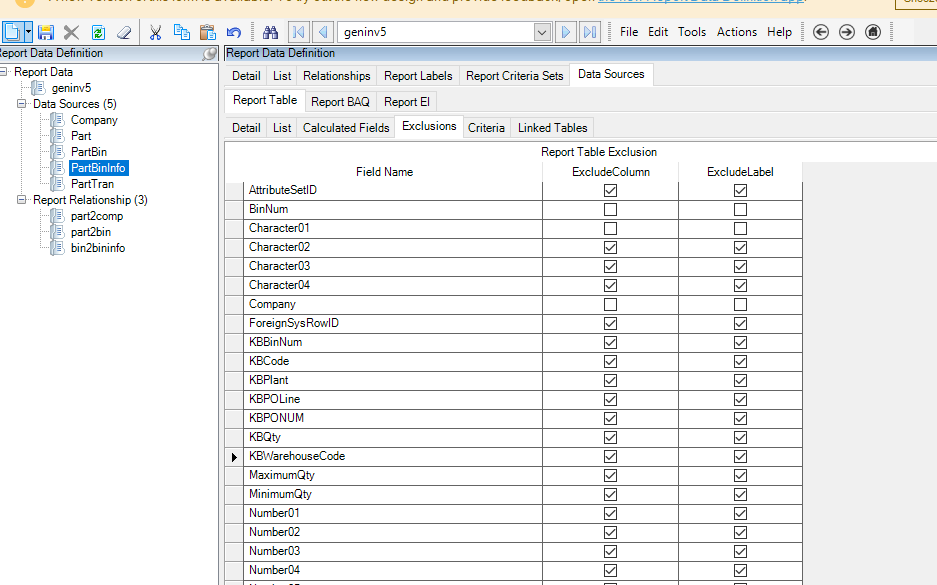

I have a custom field “Partbininfo.Character01” in Partbininfo table which I want to use.

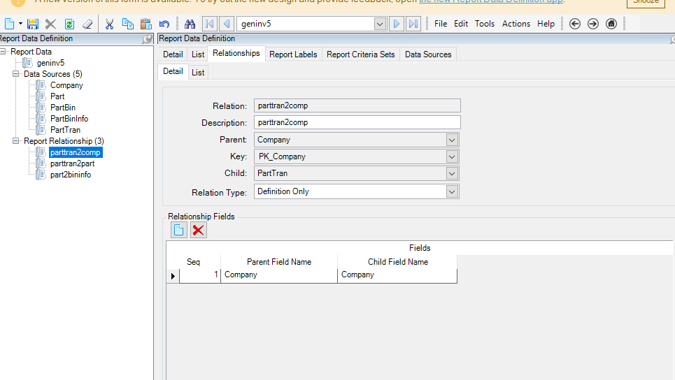

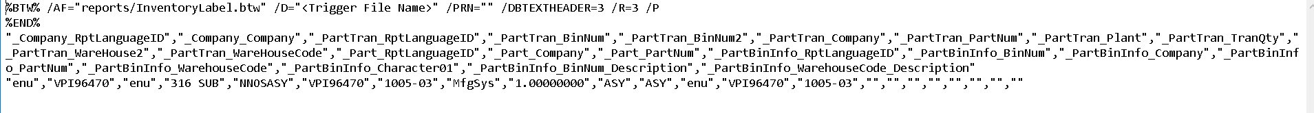

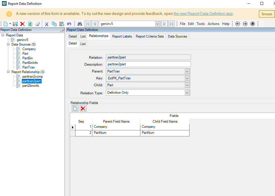

These are the current relationships, total of 3.

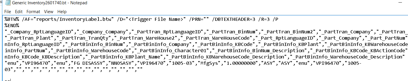

And this is the output:
As you can see, _PartBinInfo_Character01 is coming out be blank.
All I need is to figure out a way to populate those fields.
Atul,
When you join part tran to part on company and partnumber fields you are saying, give me all of the transactions for this part.
Do you want all the transactions for the given part?

I mean, the parttran table holds all transactions for a part. That’s what I mean.
If you only want the transaction that is shown in the file, the base file, not your modified one, then why are you joining part tran to your file?
@utaylor
Then can you tell what should be required joins?
Remove part tran since you have already said that you only want the transaction for the label. There’s no need to bring in more transactions at this point.

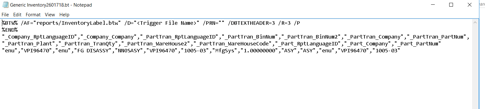

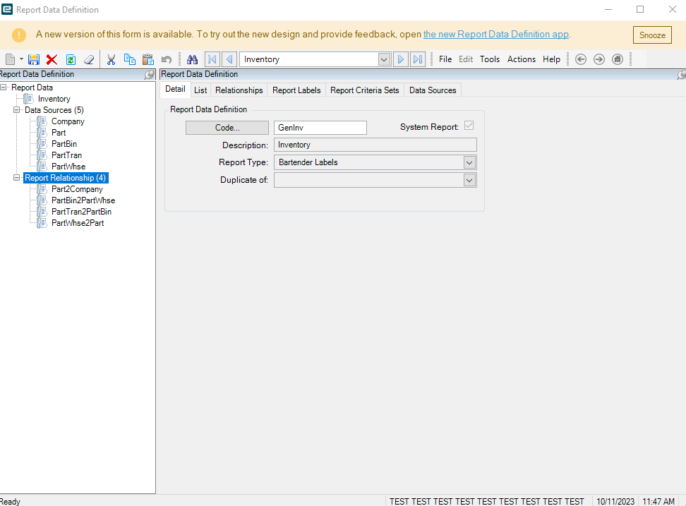

Atul, in the original dataset, not your modified one, can you identify the bin that you want more info on?
Please use the base rdd and base form at this point, we need to start over with the joins.
I need the character01 on the right.
@utaylor
should I make a copy of this? that’s the default rdd.
