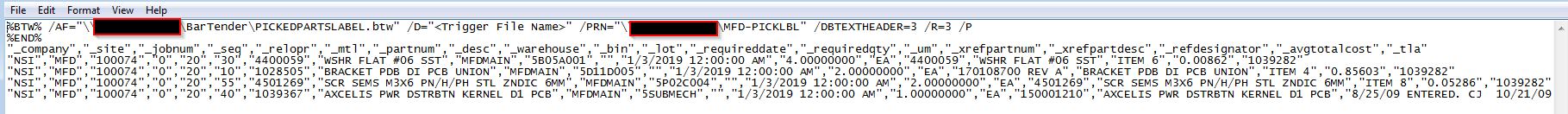

I created a dashboard and customized the dashboard to create a csv file for bartender. If I select all the rows in the datagrid and print, it prints fine. If I select 5 rows and print, the first row always duplicate.
What is strange is that the bartender csv file shows 5 rows from below screnshot. So I don’t get why it would print the first label twice. Any ideas?
Another note, if I go to the csv file and change the extension from .btp to .bt, it will reprint the labels correctly.
We configured bartender to take any files that’s got extension as .bt and once print to change it to .btp.
Are you creating 2 .btp files, perhaps you had some test code in your Customization, which you forgot about?
No, if I created two “.bt” files, I would’ve seen 2 csv files getting created. I only see the one file, yet bartender always print out the first record twice.
What if you take that .bt change a few data rows, then rename it back to .btp - Oddly enough it should work, something is off not sure what - If you rename it back to .btp and it works fine; I can rule out it’s not BarTender.
Does your “Description” field have a \r\n and the CSV is thinking you have an extra line?
I am going to change folder path to a new folder and see if it create more than one csv files. There’s too many people printing labels so I don’t know if it is creating duplicate csv or not. Least I didn’t see it, but could’ve gotten mixed with all the other csv files. Thanks for the advice and will see if it did create duplicate csv file.
