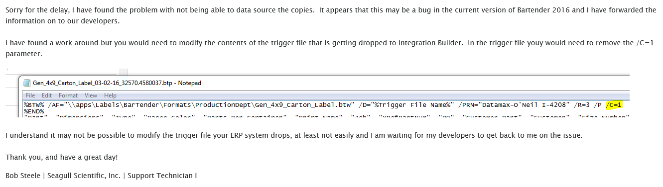

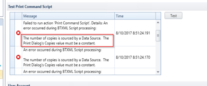

Does anybody else use values from the actual data to determine print qty for BarTender through the 2016 Integration platform? I used to do this on 10.1 with Commander but that appears to throw errors in 2016.
Yep and he’s right, you can’t modify the params that e10 drops for bt - at
least I tried and failed in e10.1.400. Another reason I moved to custom csv
solution
