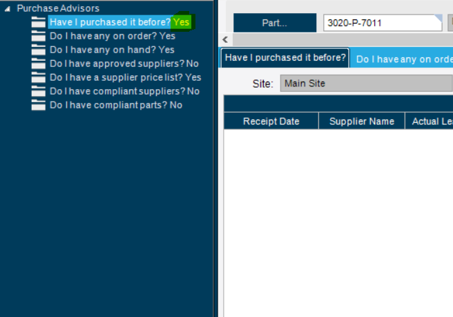

We have some custom made BAQViews which add in some extra columns to our Purchase Advisor screen. The issue we have is that the results do not update on change of PartNum, they only change if the partnum is changed and the refresh button is pressed. Does anyone happen to know a way to fix this to refresh on change of partnum?

In the above image you can see ‘Have I purchased this before - Yes’ which shows no results, but if resfreshed will return the results.
