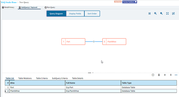

I am trying to learn how to do a BAQ I am trying to do a simple one that lists all parts and the primary bins (all parts even the ones with nothing in them). I have spent a lot of time trying to figure it out and not getting it. Is there a good place for training on them?
you simply need to figure out where the actual data is that you want. In most cases you can use field help… but the Primary BIN is always a challenge to find.
The tables you need are the Part and the PlantWhse (where the default bin for each part resides).
Here is me creating a BAQ… this took about 2 minutes.
IN the query diagram, choose the Part and PlantWhse tables:

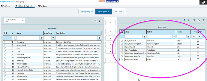

in the Display, select the fields you want to show:

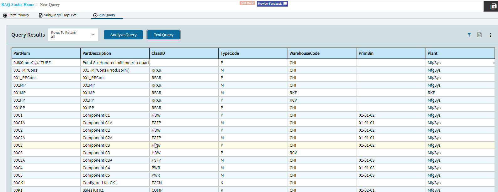

Test:
