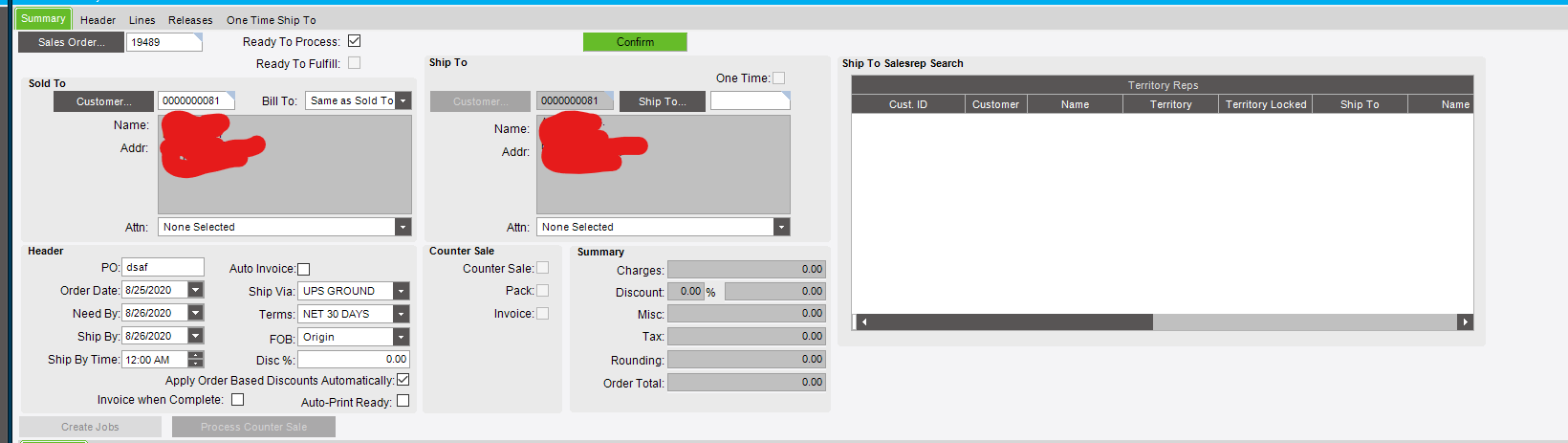

I am working on adding an UltraGrid to OrderEntry so that users can see the ShipTo Salesreps (That way they do not have to search them up everytime to enter salespersons). I was going to have the combo boxes for the salesperson default but it was too difficult to fight Epicor’s built-in logic. Currently, I have a BAQDataView that I would like it subscribed to the CustID entered so that they only see the customer information they need. When I enter a customer, no data appears.
	public void CreateBAQView()
		baq2063 = new BAQDataView("2063");
		oTrans.Add("CustTerritoryBAQ", baq2063);
		string pubBinding = "OrderHed.CustomerCustID";
		IPublisher pub = oTrans.GetPublisher(pubBinding);
		if(pub == null)
			oTrans.PublishColumnChange(pubBinding, "MyCustomPublish");
		if(pub != null)
			baq2063.SubscribeToPublisher(pub.PublishName, "Customer_CustID");
This isnt the final BAQ I want to use. I am just trying to see how this would work. It is pulling the right BAQ and the correct columns pull up but no data comes out. When I filter the BAQ in the designer for the same customer I get a few rows. I am hoping this is just a simple error somewhere?

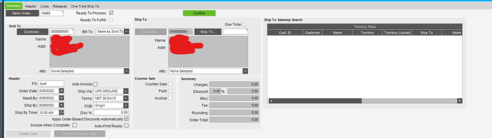

I thought this would return the whole BAQ without filtering, but I got nothing. In the designer it is 7,000+ rows unfiltered.

No luck. I am thinking it has something to do with the BAQ (maybe because of the Customer table?). I changed it to a simple BAQ of some of the OrderHed fields and the publisher/subscriber worked fine. Although, maybe that is because the OrderNum is already being published in the Order Entry form?
Got it! Simple mistake: I was using the EpiContextMenuKey instead of the actual EpiBinding for the field I wanted to publish. I also forgot to take out a filter in my BAQ when I was testing it. Thanks for helping me troubleshoot!
