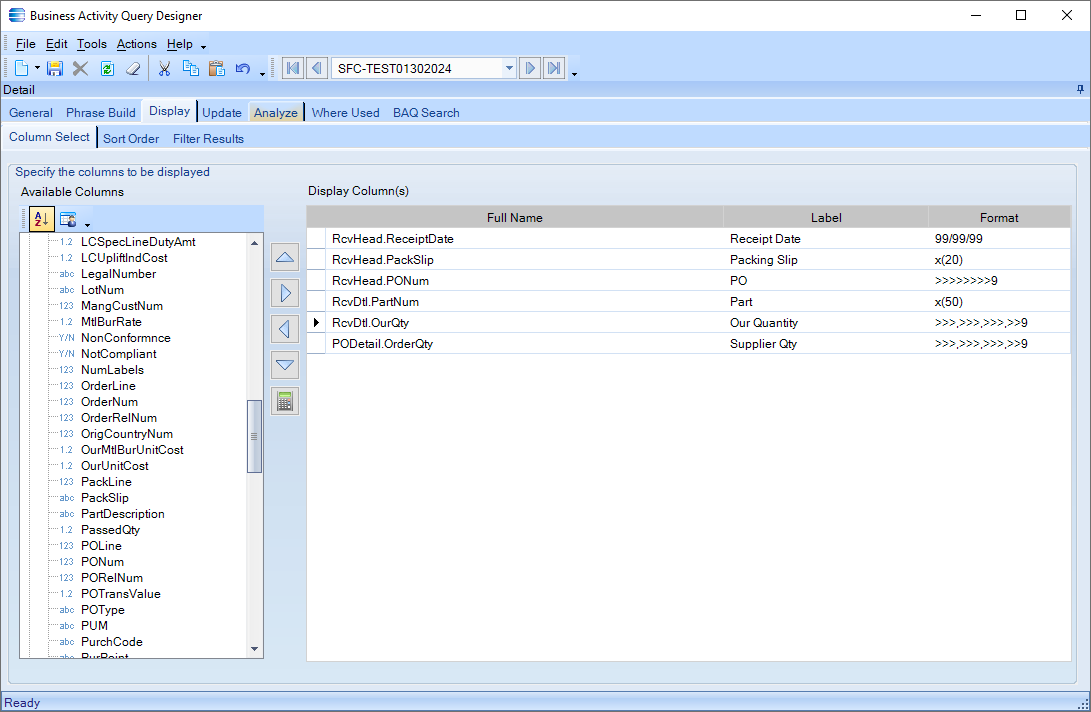

Hello Trevor,
I am using this on my test: See below:
The problem I am having is Rcv.Dtl.Our.Qty is per part and the PO Detail Order Qty is for the PO complete. I want to compare in total the total amount recieved against the total amount the purchase was for. So I can display the PO’s that don’t match.

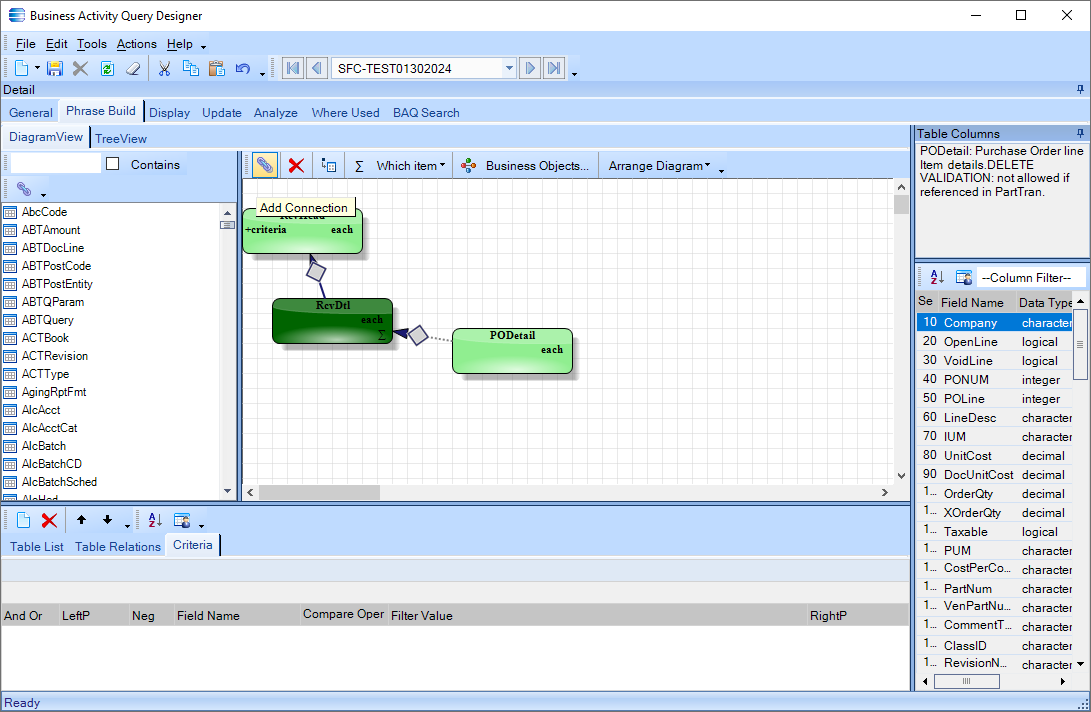

In 9 make RcvDtl an aggregate table.
Hello Greg,
How to create a aggregate table?
Thank you.
Miguel
There is a Sigma button in the tool bar that in E9 made the table a summary table. It will be (I think) green after that is checked.

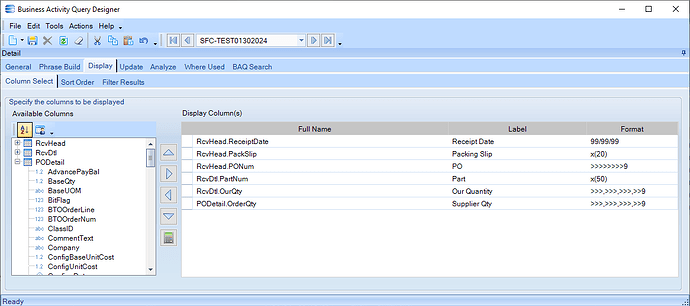

below is my setup.

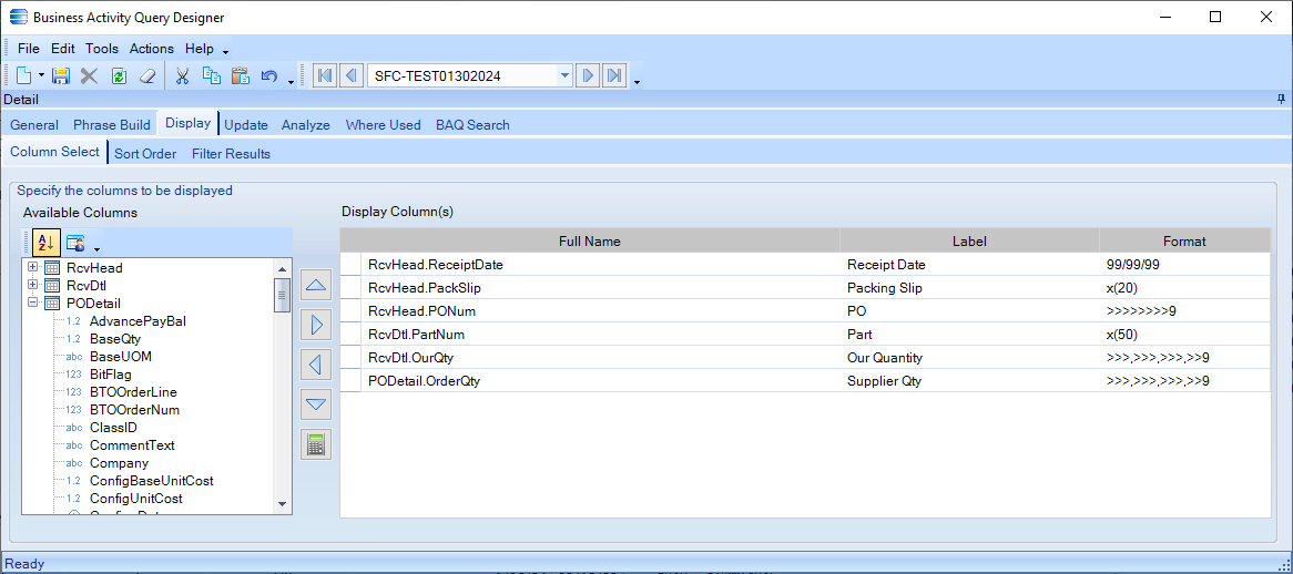

Here is my data I want to see.

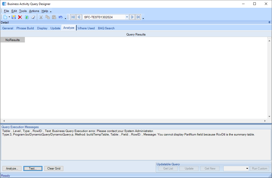

This the error I receive.
