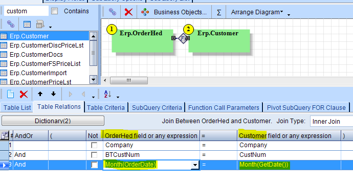

If you only want the totals for one month of each year:
If you have two tables in your query, you can filter it to only include orders from the same month. Do this in Table Relations so you can use an expression on both sides. When I made this as a test, I joined the Customer table, and set the Customer field/expression to “Month(Getdate())” and the OrderHed field/expression to “Month(OrderDate)”.
In Display Fields, check “Group By” for State and remove the other fields from display. Create three calculated expressions:

Can you elaborate on the first paragraph? When I am in the Table Relation between Customer and OrderHed I don’t understand what you mean with “set the Customer field/expression … and the OrderHed to…”. How can I set like this in the Relation?
You can type freely in the Table Relations fields, so it’s one way to get around the limitations of Table Criteria and SubQuery Criteria.
Month(<date>) gets the integer value of the month of the given date, and GetDate() is the SQL function for getting today’s date. So we’re saying, only include orders placed in the same month as today, regardless of year.
Ok I understand now, thanks again Ashley. Always on top!
