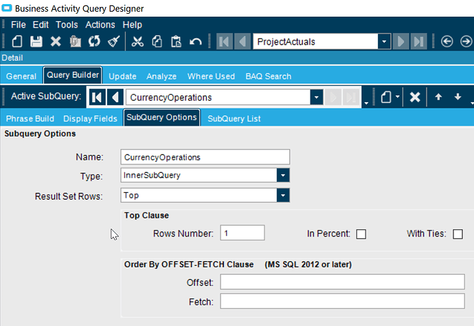

If on the CurExRate SubQuery I change it to Return Top 1, it only returns 1 row and not one per LaborDtl.

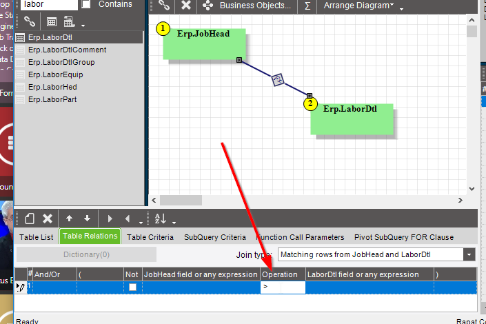

When you do the joins to your subquery you can type in < or > or <= or >=. It’s a little weird because you almost never do that so you don’t think about it, but you can.
It should. Are you in the joins? Or the subquery criteria? You should be in the joins.

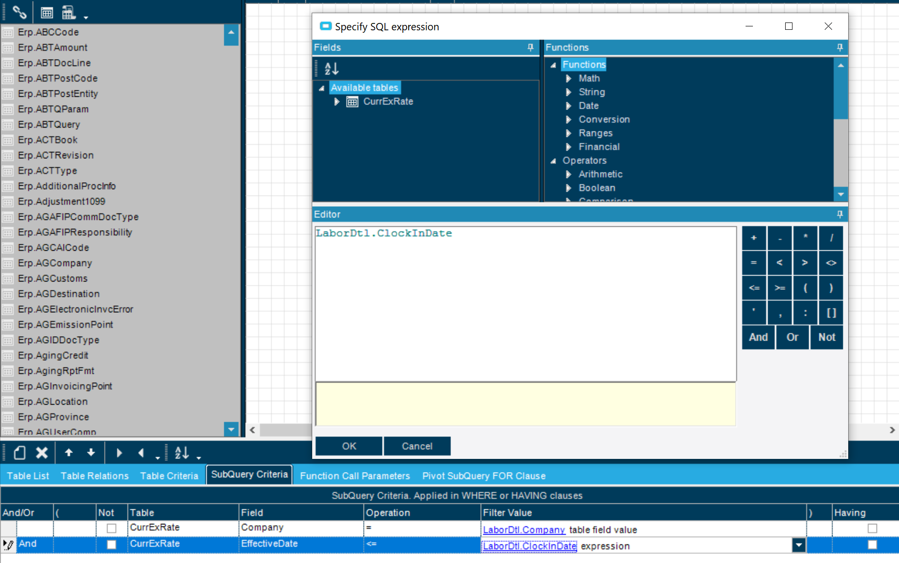

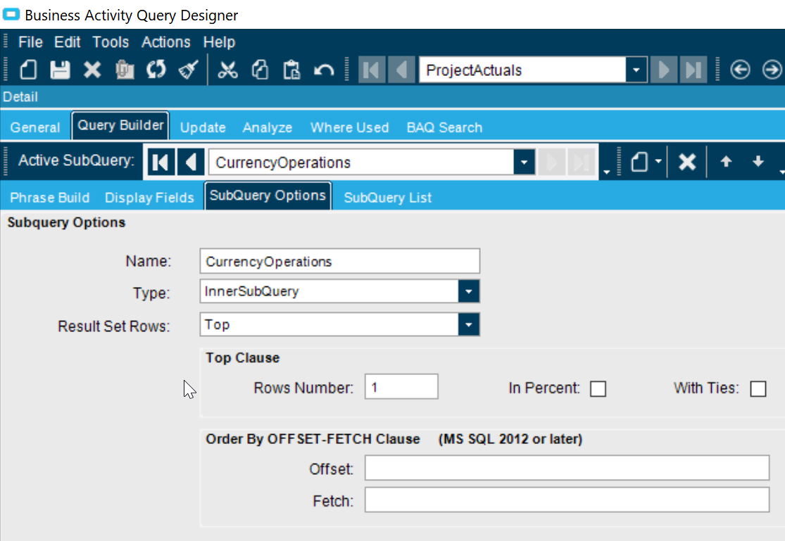

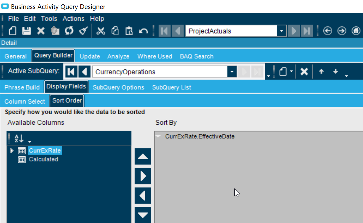

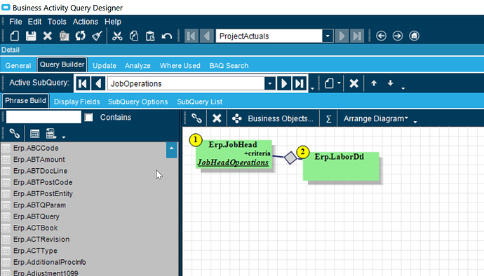

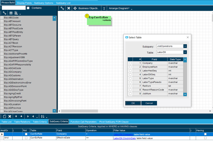

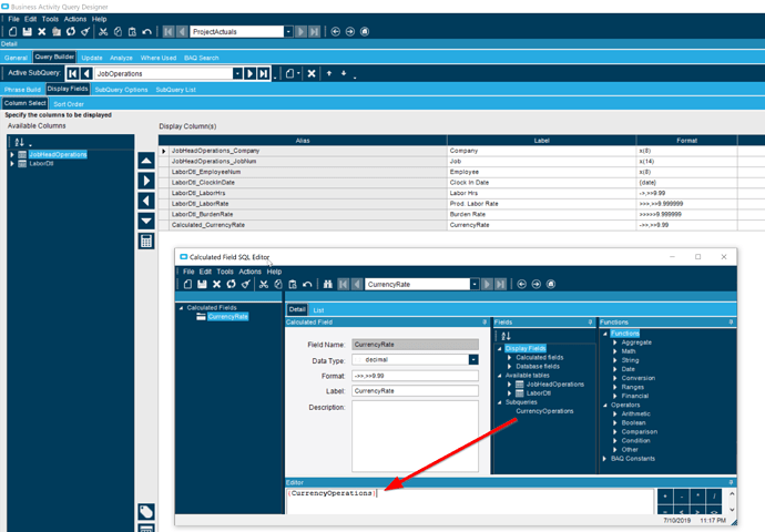

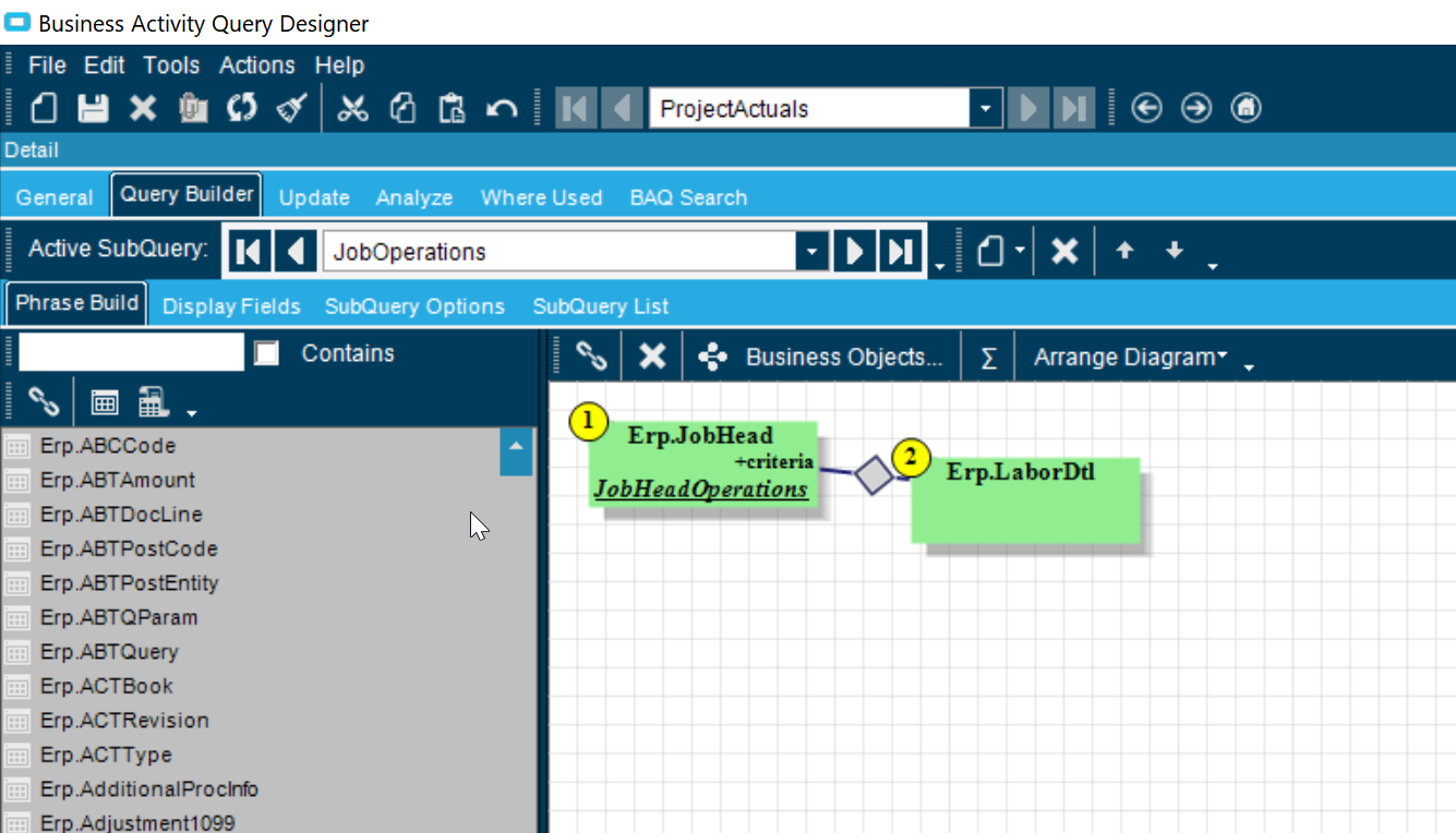

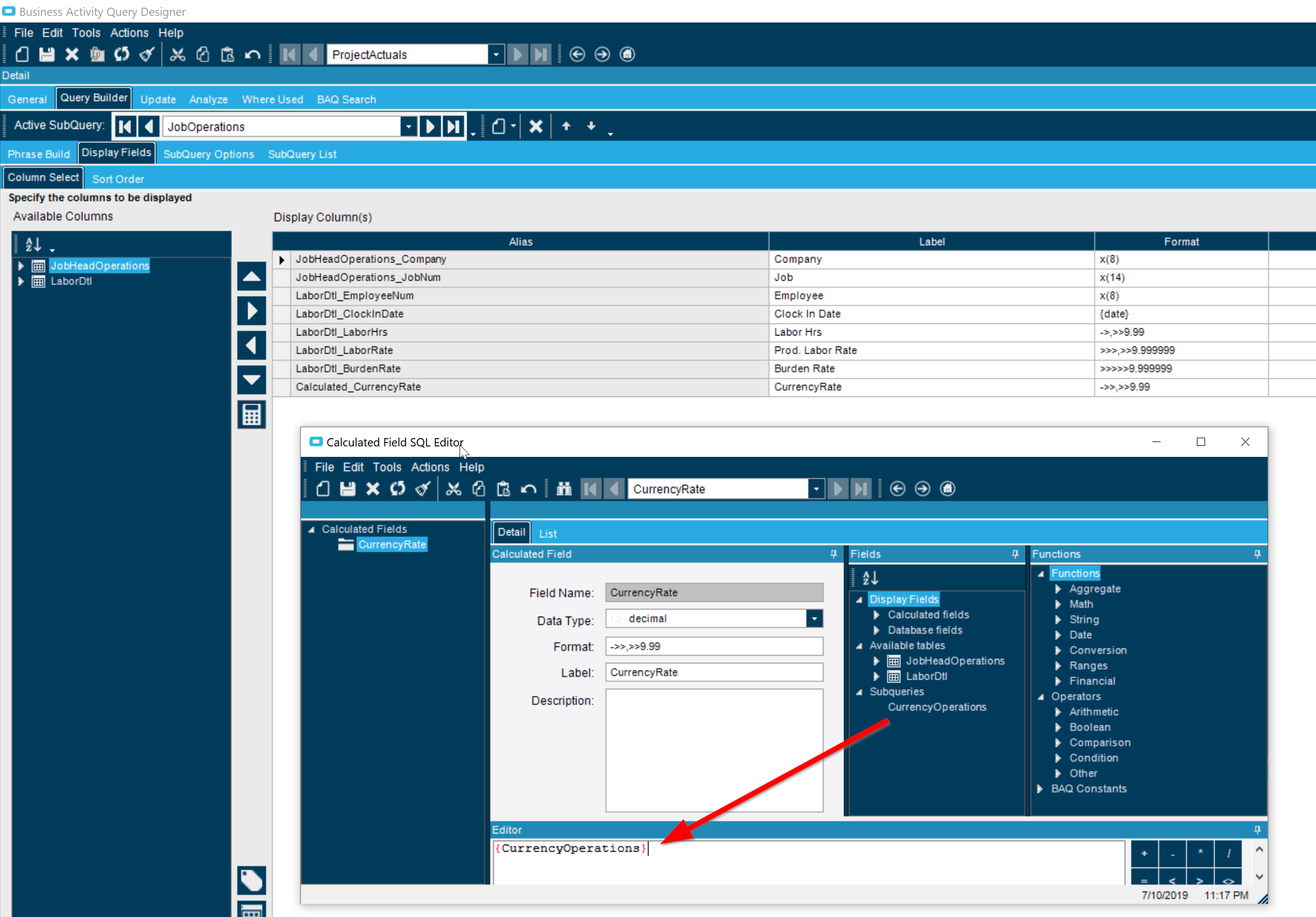

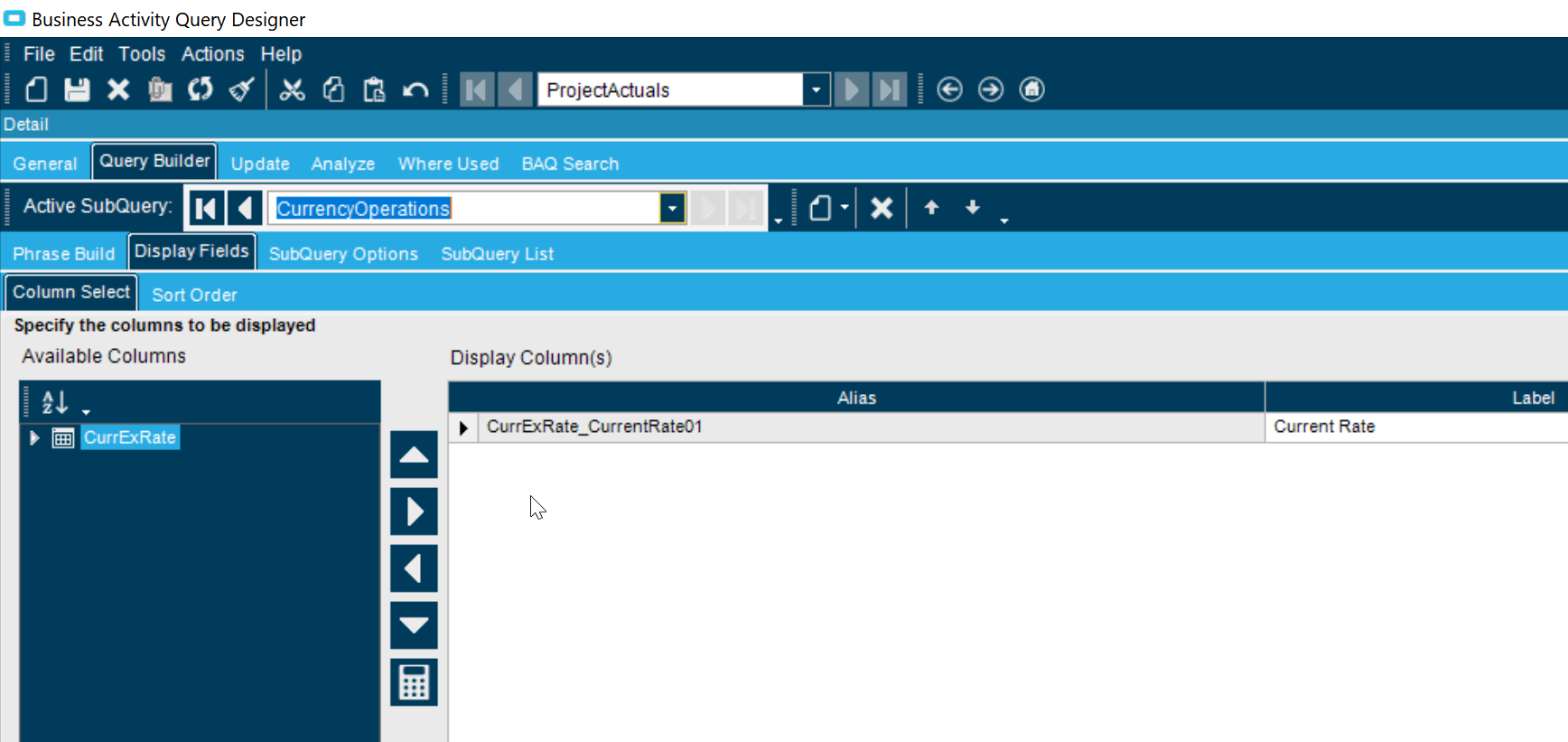

You’re on an older version of E10 so I’ll give you some screen shots of what I did
In your job operations subquery, get rid of both of the other subqueries.
So that should get you the currency rate for the date when the laborDtl record was created. I think you should be able to take it from there.
I don’t have any data to check any of this with, so hopefully that makes sense and I didn’t mess anything up.
One more note about the date and the ranges, I think there might be a bug where the date fields won’t compare correctly, and if you run into that, make the field equal to an expression and type the table and date field in that way. I don’t know why that way works, but I think I remember having to do that before.
FANTASTIC - thank you so much. So basically because I had three fields (rather than one) in the Currency Operations sub query it wasn’t working and wouldn’t allow the Sub Query Criteria.
I didn’t know you could reference a single field sub query through a calculated field without joining that sub query in. Yes in essence a mini sub query or a sub sub query!
